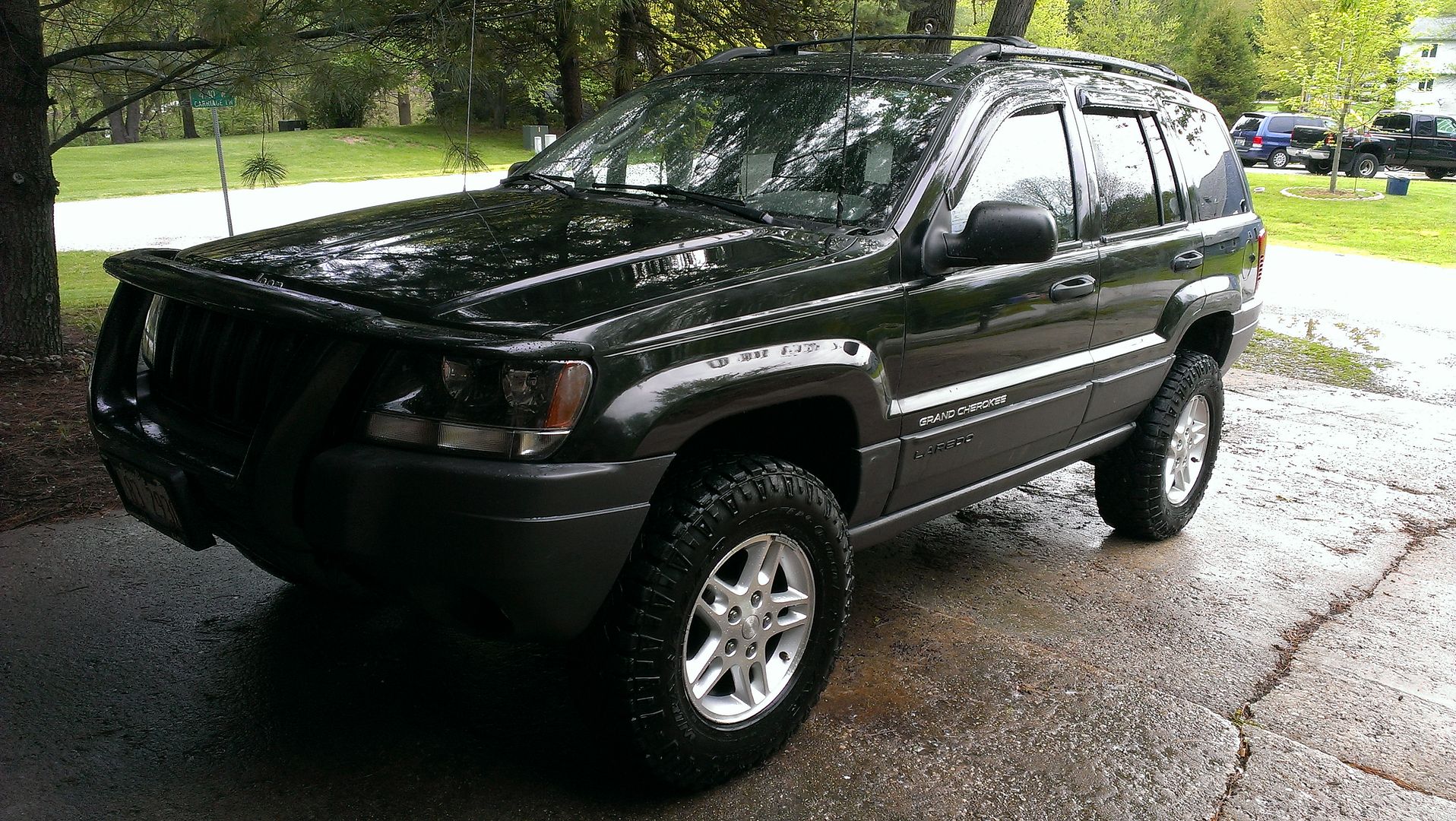

WJ w/2-inch BB, RC 1.5 spacers with OEM 16" silverblades sporting 265/70/R16 Cooper AT3 shoes...

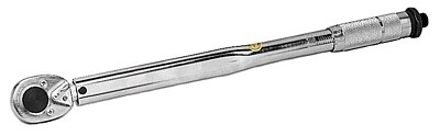

Anywhere really - Lowes, Sears, Amazon, etc. Get a decent quality torque wrench, an extension, and the proper size socket(s) and you should be good to go. I personally am a fan of the click type but it's up to you which kind you go with.

styles of torque wrenches for reference:
most recommend you use this during install:
install correctly and your spacers should be GTG. Be warned that some tire shops will not mount new tires if you're running these even if they are hub-centric which cheap knock-offs may not be.
