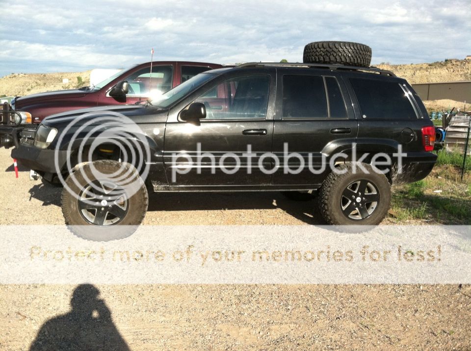

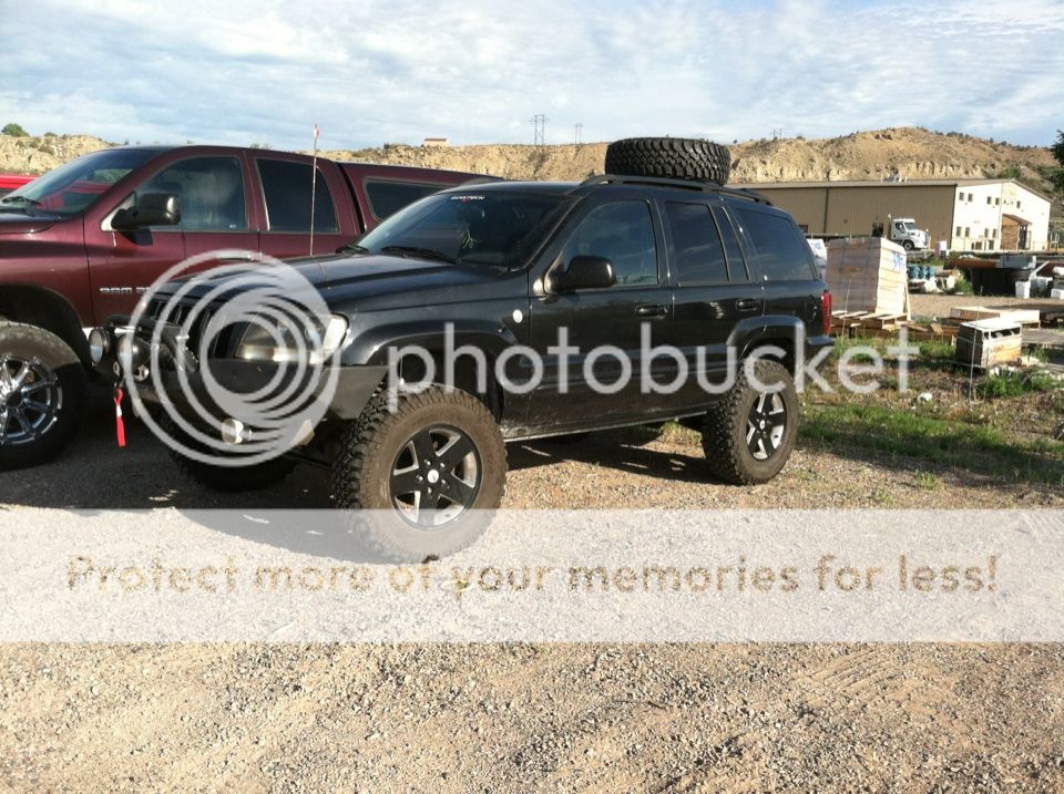

Hybrid 4in lift

Is this jeep running 3" coils in rear? Looks shorter in back for 4"?

Nope iro 4in coils just did the lift last night front coils haven't seated in isolators yet also running 3/4 spacer in the front
