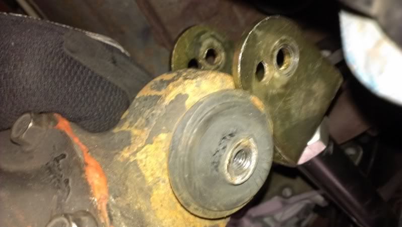

The bushings were installed without incident with the exception of bending my new Miller long bolt.
