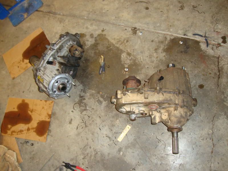

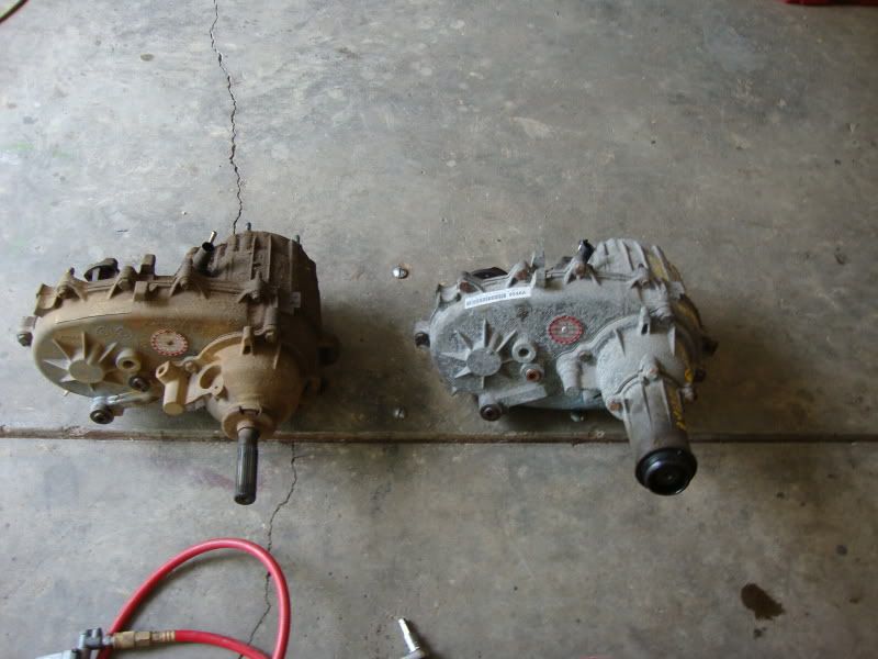

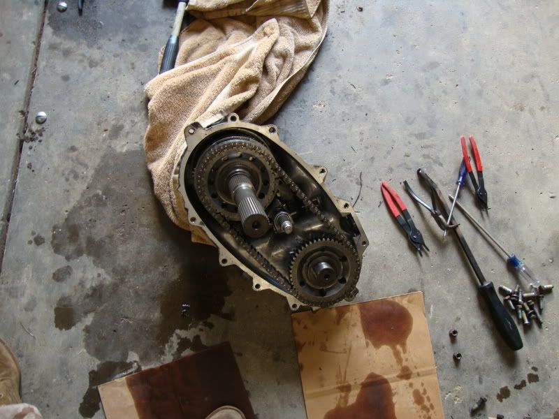

Finally got around to swapping in the 242HD.
Wont bore everyone with details since TC swaps have been covered on here in detail.

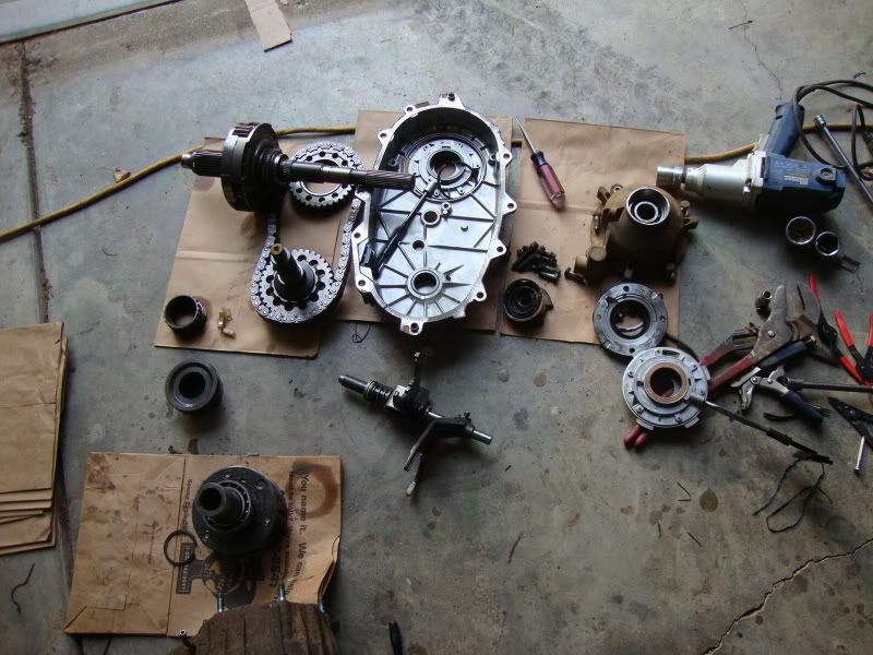

Took about 4 hours to swap it including lunch. Had to swap out the input shafts which took about an hour. Everything looked good. Hardly anything on the magnets so that was good.

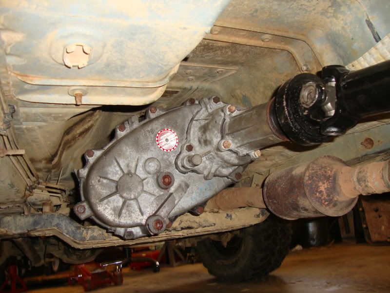

Had to swap out the studs from the LD to the HD that mount the TC because the HD were longer and you couldnt get a couple of the nuts on after you installed it.

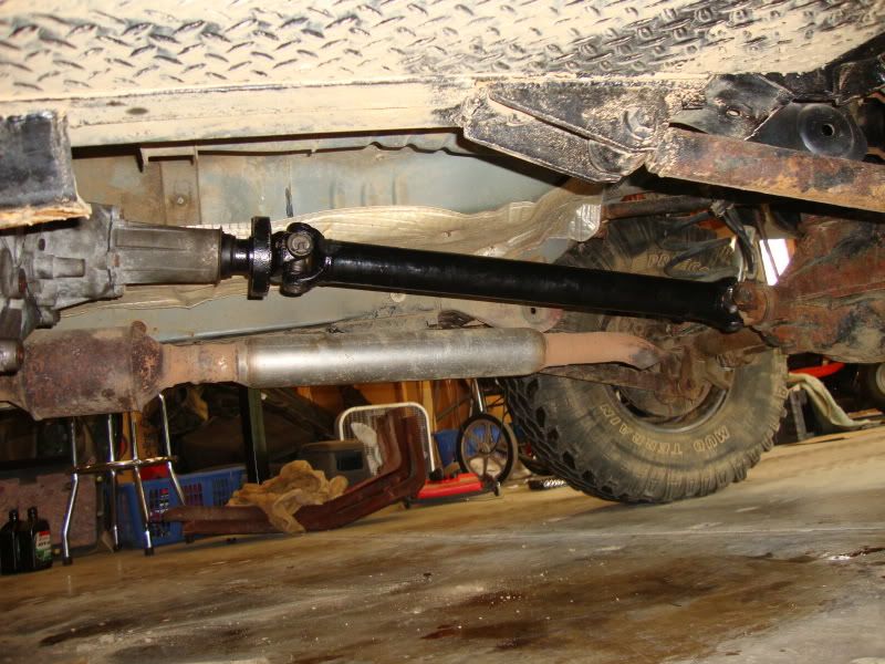

Rebuilt the V8 drive shaft with greasable joints, wire wheeled it down and painted. It fit perfect after the TC was installed. Took it out for a spin when I was done. Got it up to 80 on the freeway with no vibes. Then to a field and ran it in all the TC selections and worked fine.
Here are some pics.
The TC's. You can see the longer input shaft on the V8 TC (the clean one on the left)
Tearing down
All put back together with input shafts swapped
Installed
Old 242LD with V8 shaft installed
Good work...Now THAT is a drive shaft!
