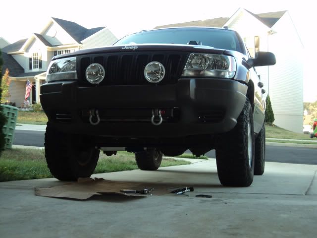

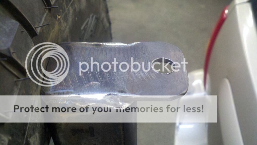

Received my Custom Front Tow Points today
MORE PICS IN BUILD THREAD !!!

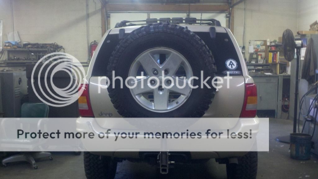

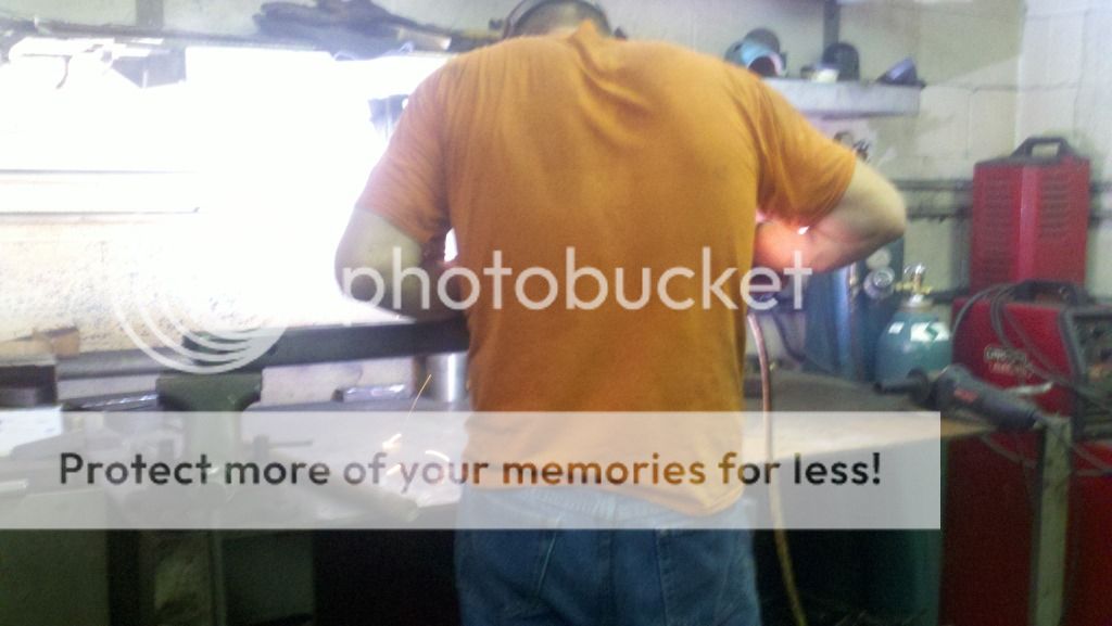

Went over to my friend's house/machine shop today and got the tire carrier built. I'm going to slap some paint on it tomorrow.

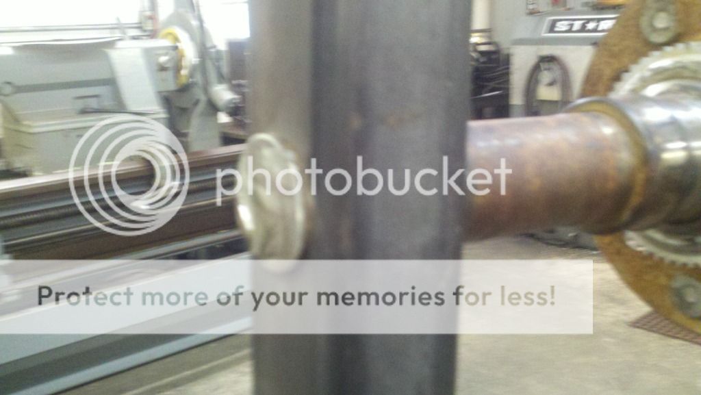

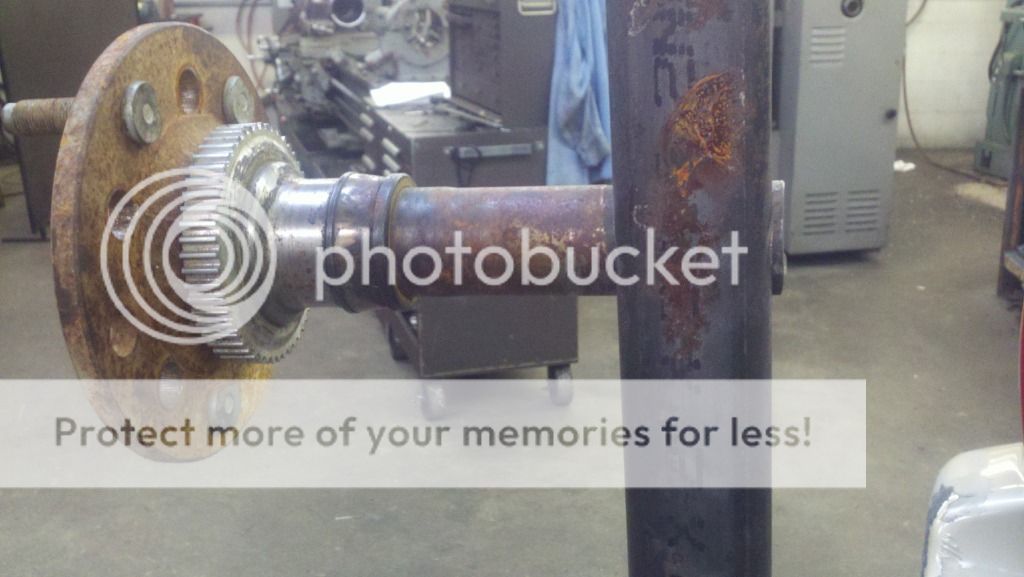

He had a bent-spline JK axle shaft he wanted to use for the mount. Pretty cool looking if you ask me.
JK D44 axle shaft:

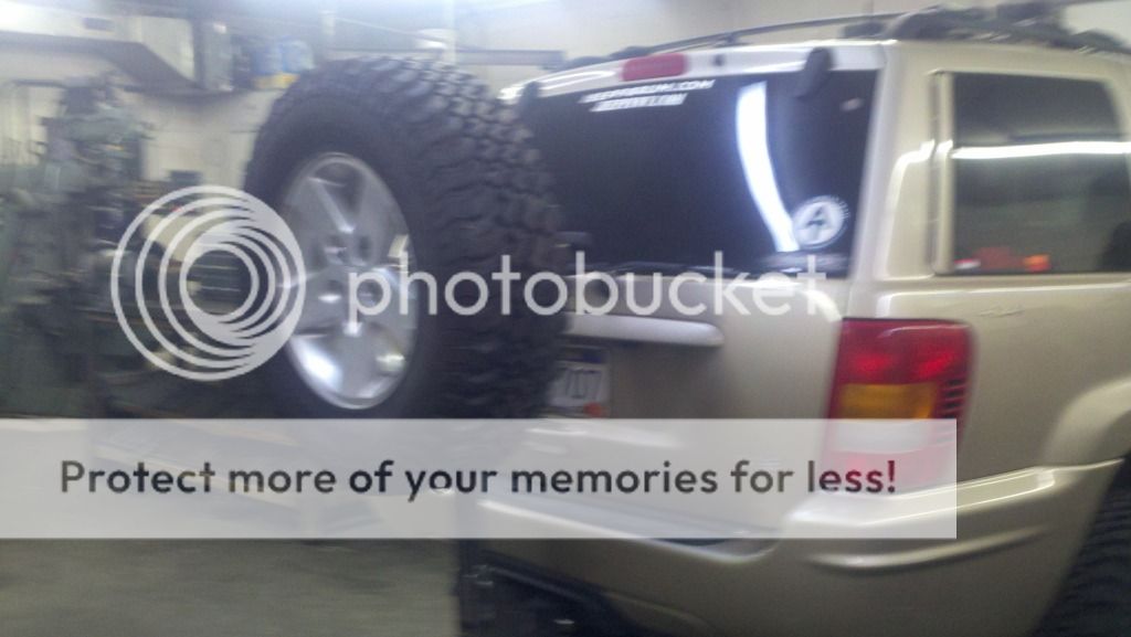

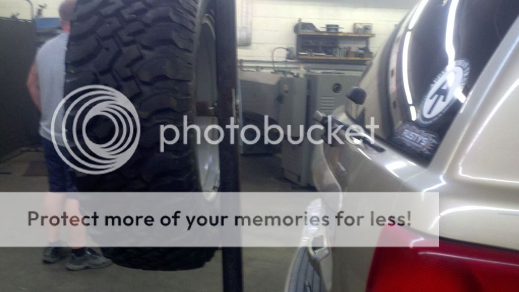

The glass still opens.
This was an accident (the angle) but I like it, and it doesn't seem to hinder hatch access at all like this.

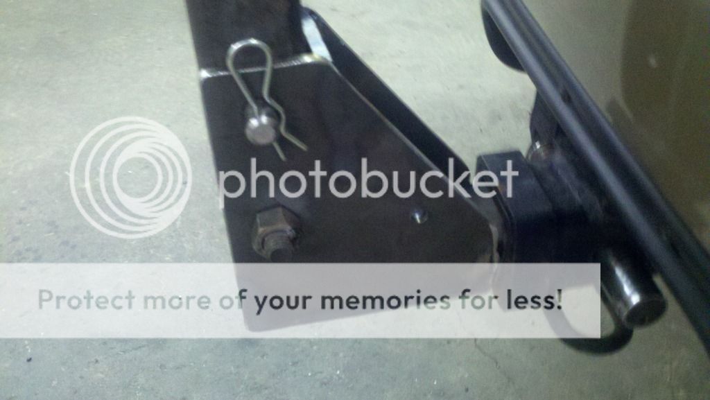

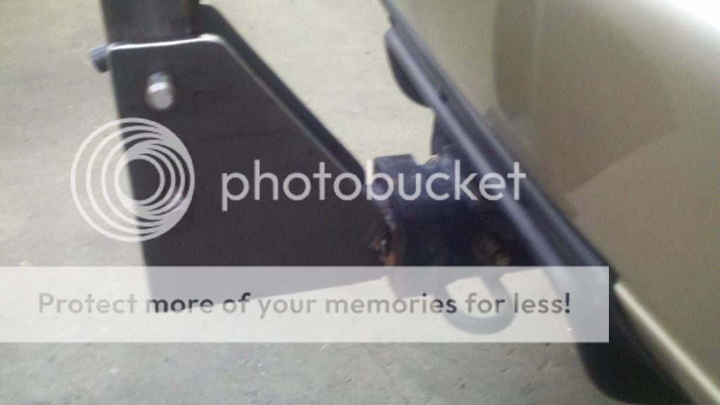

This bracket was put in to keep anybody from slamming the carrier into the window/gate, but serves as a stop for the arm, so I don't have to lift it all the way off the ground.
CB Antenna mount at the top
I'm really happy with it. I need to slap some paint on there, and rig up my license plate. I had the rear camera on the hitch, but had to take it off when I finally put a hitch bezel on. I'm thinking of mounting the license plate under the tire, with a light right up behind the lower part of the tire, and then putting my rear-view camera on the license holder. I'm toying around with the idea to build a bracket for the camera to stick out of the top, center hole in the wheel, for a higher point of view.
What do you guys think?

^^^^^^ Wow That tire is Super far away from the rear of the Jeep

it is a little out there. It's as close as it can get, without bending the vertical part. I considered tilting the top of it down, but I like how I can still open the rear window. A bumper or other swing-out is for sure in the future, but this was cheap and necessary for me to not have the spare on the roof for a 1200 mile trip (it drags 3mpg off)

I like it a lot. I like how it swings down just enough to get the hatch open. Only thought I have about it is that the straight up and down bar leaves a huge gap from the back of the Dub.
What about putting an angle on the main beam to flow a bit better with the rear of the dub? Like angle it just below the bottom of the rim? Give it more of a fit look.

Looks good, but are you gonna add more bracing? Like a triangular setup?

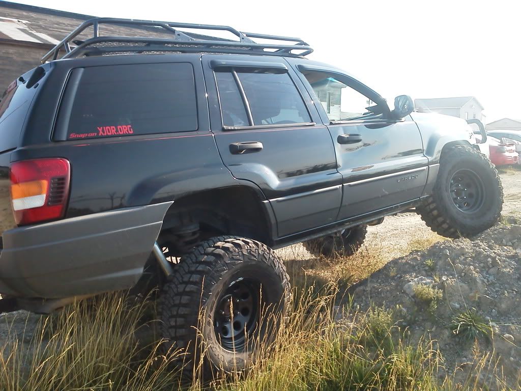

flexed it out to see where trimming would be needed
