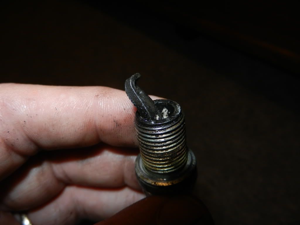

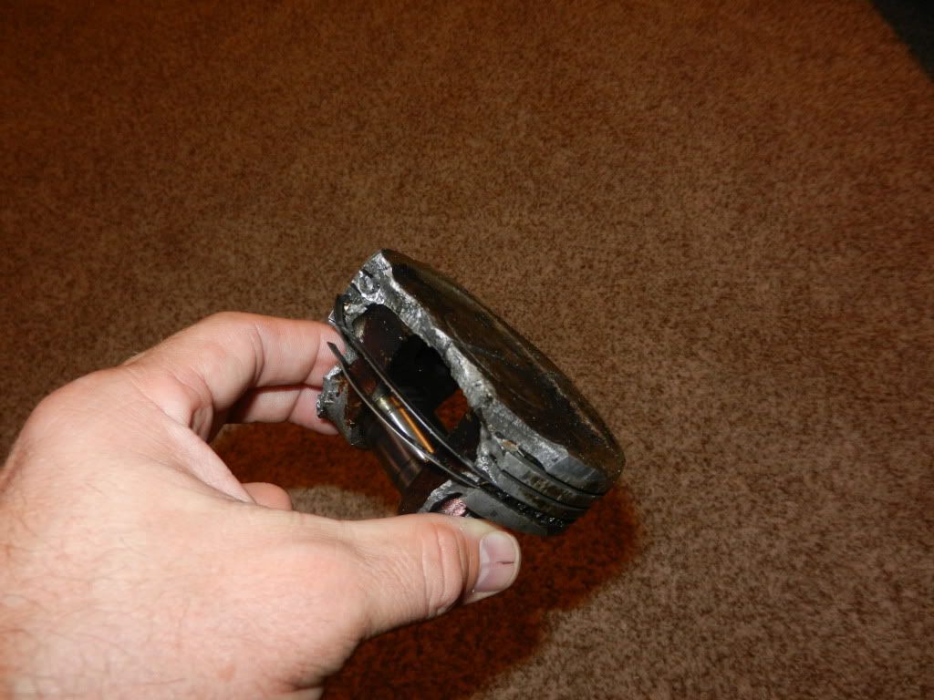

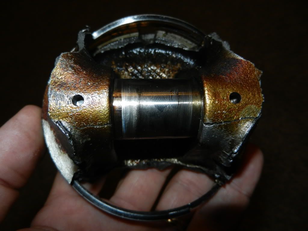

Well, the engine ticking I've have for the last year or so recently became a much louder clacking. The clacking only lasted about four days before the engine gave out at 162,719 miles. Right up until the point where the engine died, it ran great. If you couldn't hear the noise, you would have never known there was a problem. These I-6s are some tough engines.
These pics are the remains of piston #1 (front piston in the 4.0 liter I-6). The rest of it was in the oil pan.
That crack goes all the way through the piston. The only things keeping it in one piece are the rings and the wrist pin.
This last pic is of the spark plug that came out of that same cylinder.

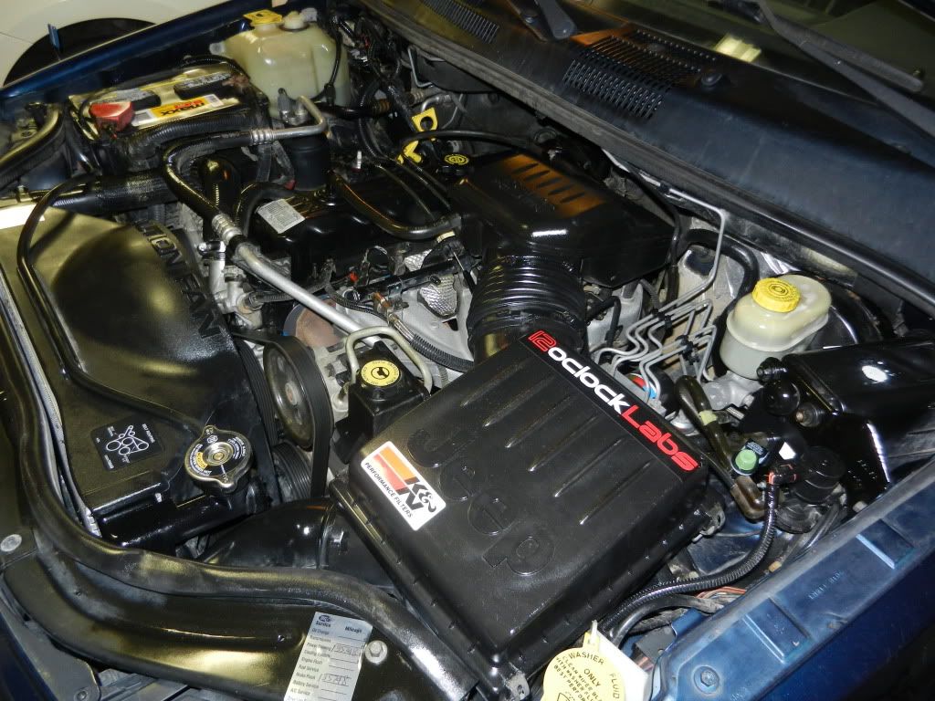

FINALLY got my Jeep back out of the shop (18 days), with a brand, spankin-new engine rebuild completed. I had to take a picture, it hasn't been this clean since it left the showroom.
So pretty!! Kinda wish I could get mine that clean but I know it wouldn't last long...if I may how far back did that set you for the new motor and all?
How much? 2K installed?
$2,450 + tax
I also had them replace one of the motor mounts so that was an additional $146+ tax.
Also, this isn't a crate engine; it's a rebuild of my original long block, performed locally. All new rotating parts were replaced except the crank, which was machined.
'99 WJ Limited 4x4, 4.0L, Patriot Blue Metallic, IRO 3" springs, track bar, and rear sway bar links, Doetsch Tech 8000 shocks, Tenneco steering stabilizer, Carolina Driveline double-cardan front drive shaft.
Mine was #6 piston at 150k

Originally Posted by MadMonk View Post
$2,450 + tax
So you coulda added a crank and rods from a 4.2 and came out with a 4.5L...
