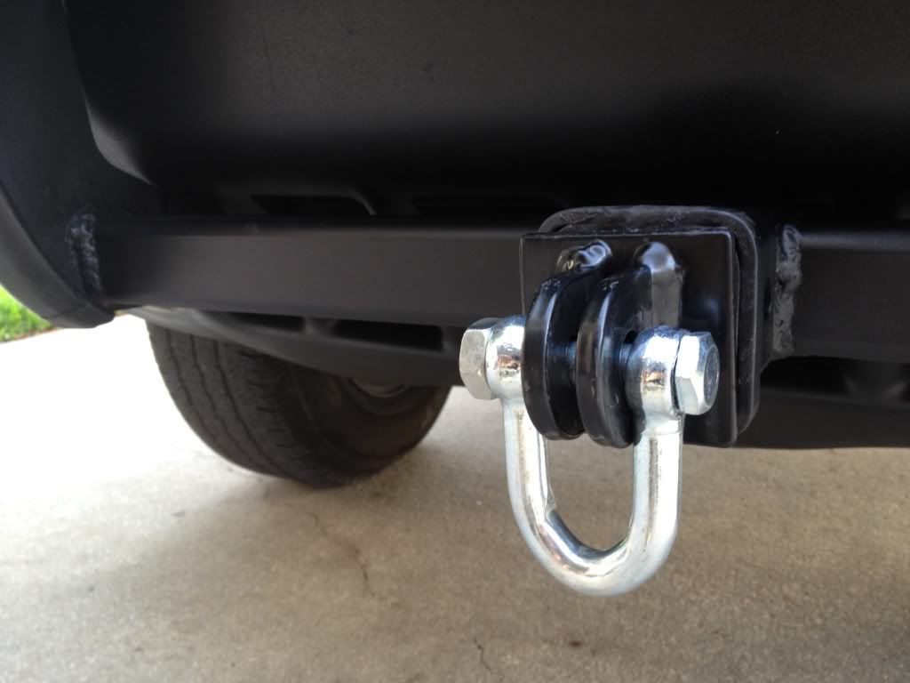

Custom front hitch/brush guard
So today my brother and I took on the project of modifying my brush guard to have a 2 inch hitch receiver. Now I am able to have a recovery point, along with a winch or what ever else I would wanna plug in there. The brush guard mounts were 1/4" steel, so we backed that up with some 1/4" square tubing and I had my brother weld it all up. I am really happy with the end product. Much cheaper than a Warn hitch, and should still do me just as well.
