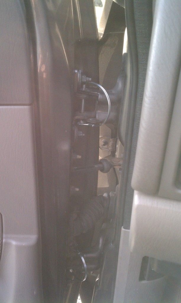

thestig_wj
Location: valparaiso
Posts: 282
started to make the doors "quick disco" sorry this is the only pic i have, as soon as i got the door off it got really cloudy so i just hurried up and finished the pins
what size pins did you use? and what do you think can be done with the door stop arm?
Not that I will ever try it, but what about the cables?

thestig_wj
Posts: 282
dont remember off hand the size of the pins i can get it for you if you want but they are a pretty beefy but fit thur the holes without having to drill them bigger, as for the door stop arm im working on a nylon strap (kinda like whats used on the TJs) but with a dog leash type release on one end
phantom by cables do you mean the wires for the windows and door locks? if so then its easy there is a "harness" that just clips together under the rubber, i just broke the clip to make it faster to take apart and just used the red sliding lock thingy plus its pretty snug once its together so its not coming apart unless you pull on it

thestig_wj
Posts: 282
Originally Posted by Lysdexic View Post
Just one question.
Why?
So I can just pull 2 pins instead of taking off 6 bolts when I go wheelin plus half doors are in the works so I can switch between the full and half doors easier
