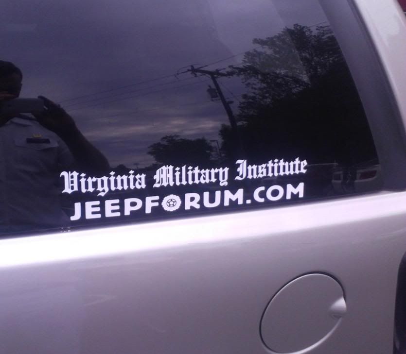

Started taking off window deflectors. Then it started raining. I'll finish it whenever the rain stops. Also put a new sticker on

Awesome!

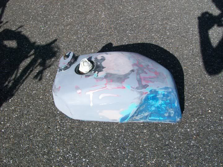

I've done a lot of stuff on motorcycles and I don't ever go down to bare metal all over. A tip for getting a smooth finish: I like using different colored primers for the different layers of primer. Make sure they're compatible (same brand, composition etc) just different colors. That way, when you're sanding, if you see another color show through the primer, you can find imperfections easily.

nice call great info I will be doin a fender aswell hopefully soon. that looked like a drivers side fender mines in need of replacing due to rust gotta love ny
