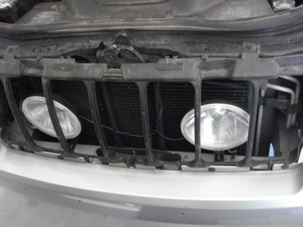

Love the lights, does the grill affect them much, and what type of lights are they?

I put some cheap Walmart lights there and the wires coming out of them melted. I guess they came loose and touched the radiator. Have you had any problems with that?
when I did mine I pulled them forward them and ziptied them to the grill supports in the center to make sure they will not touch the radiator....
they are very close to it though, but no melting and I've had it this way for almost 2 yrs.
you can see how I brought the wires to the center here.

the grille doesn't effect the light at all for me and heres a pic of the mount i made from some pipe tube and scrap metal. i had to raise them up and back so they would fully shine through and could point them down rather than at the sky.

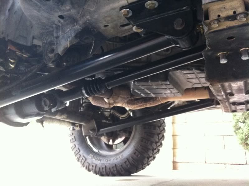

4 1/2" lift IRO longarms installed. Such a nice ride, now the rear sounds clunky. That's next.
Changed the Power Steering fluid too. It was really brown and seemed kinda thick.

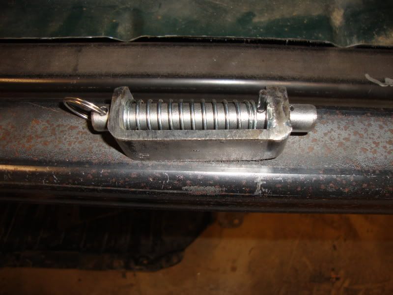

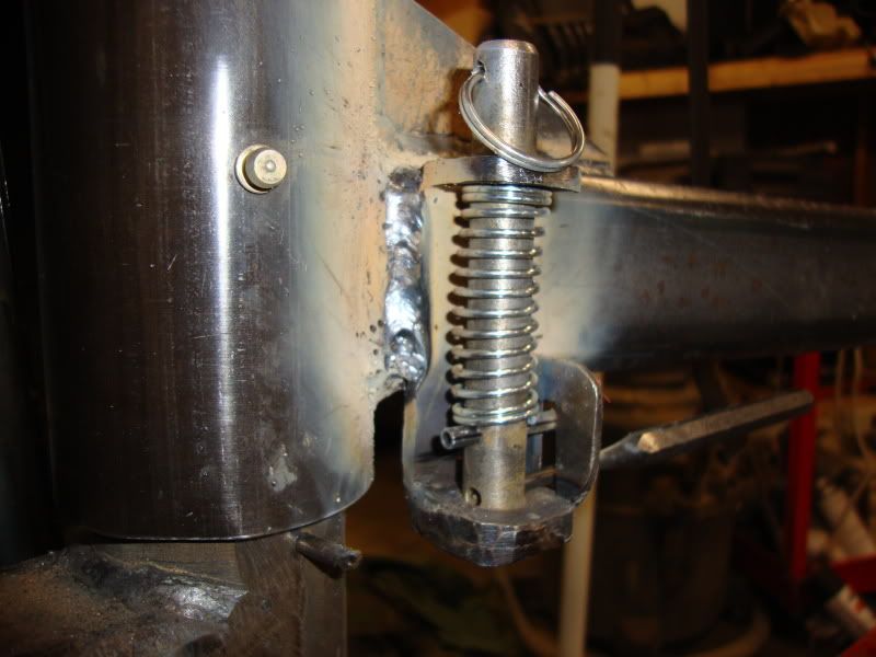

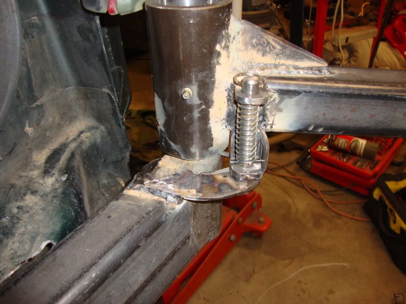

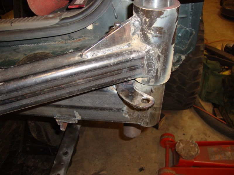

Built a stop for my tire carrier.
