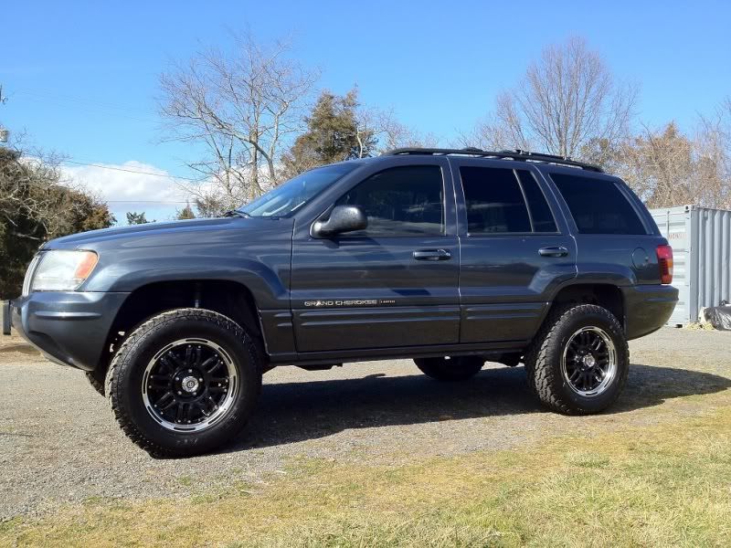

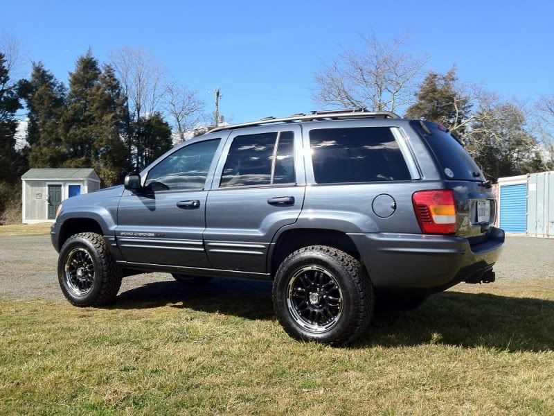

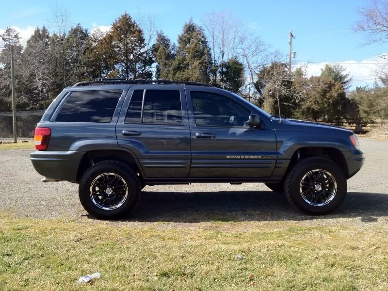

Since I haven't updated anything in awhile, this more of an update then what I did today. I ditched the BFG MTs and JK Moabs. I opted for some ATX Assault rims (17x8, +25mm offset, 5.47" BS) and some General Grabber AT2s. I also put on a JKS trackbar and HD TR and drag link.

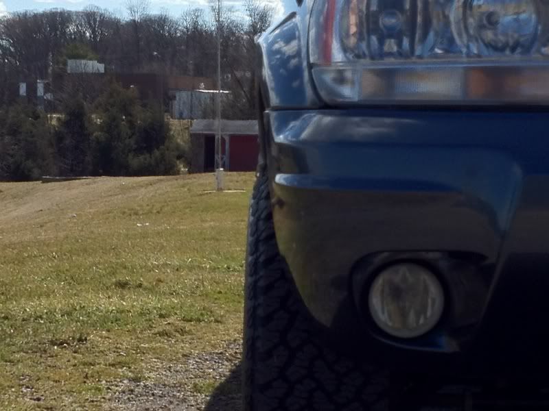

With the 5.47" of BS and +25mm offset the tires sit just perfect.

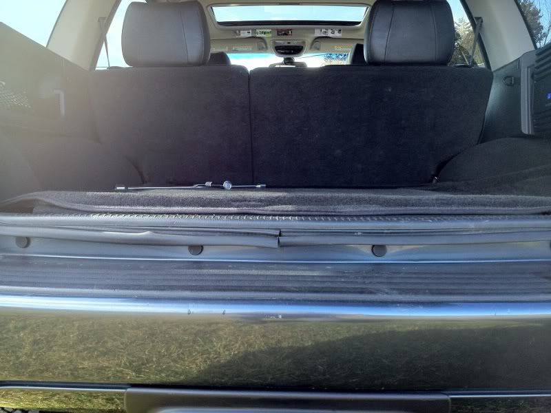

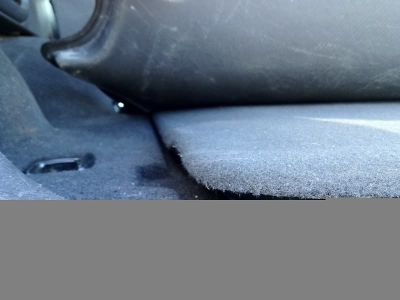

The 255/65s fit in the spare well just fine. The lid does rise up just a bit but, with the cargo mat, it's hardly noticeable.
Upgraded the stereo and mounted the Alpine amp in place of the CD changer.
