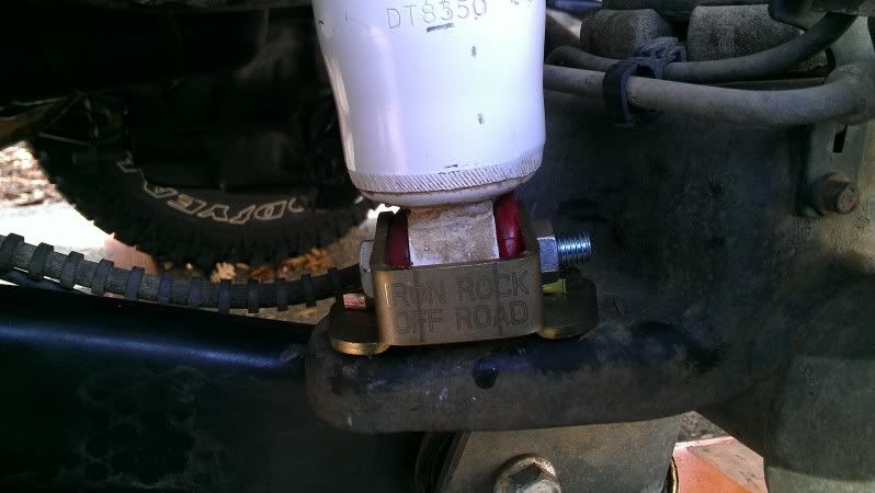

Got my IRO Bar Pin Eliminators on today. Attempted to do the A-arm spacer and the ball joint would not come off of the arm! Got to get a new one and figure out how to get the old one off.

What's the point in Bar pin eliminators?

I guess it makes it easier to mount your shocks? I dunno. I took mine off and tossed em when I did my recent install. Couldn't see them really doing all that much. More trouble than it was worth to reinstall

The bar pin eliminators stop the clunking from the shock sliding back and forth on the bar pin.

Hmm interesting. I've never had that problem.

Sorry for the late reply but it allows for compression on the shock bushing. If you notice with the bar pin, there is load on the bushing allowing "clunks" to happen since bumps in the road and what not are not being absorbed by the bushing. It also gives you a little more downtravel since it moves your shock mount up a tiny bit.
