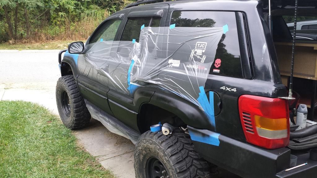

Spent a little time over the long weekend doing odds and ends. Replaced the hood struts and passenger window motor/regulator. Neither of those have worked for probably 10 years LOL. I also finally painted over the cladding. I cleaned with dish soap, and Krud Kutter, lightly sanded, sprayed plastic primer on the cladding, and Rustoleum bed liner from the spray can. I like the way it came out...just hope it lasts.

Looking good
