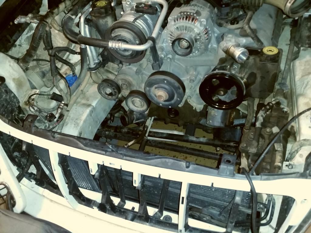

Started on the front crankshaft seal today.
Harmonic balancer has a slight groove worn into it. Should I replace it?

If you can't catch your fingernail in it a little bit of really fine sandpaper should buff it out. Not sure but they might make a speedi-sleeve to go over the balancer snout.
