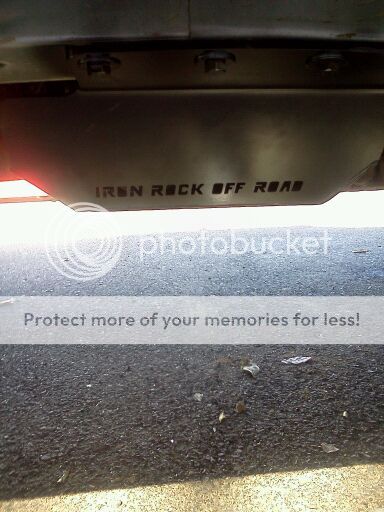

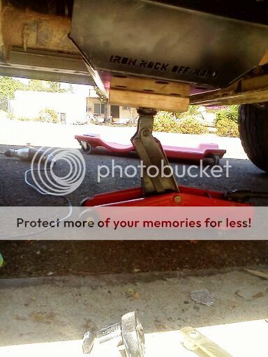

Installed the Iron Rock TC/Cat skid plate today
Good instruction sheet, took about 1.5 hrs. with just myself, a jack and a couple cold beers. The 29/64 drill bit needed is a 7/16, for those not good in math
Line it up, check your clearances and drill away. You do need a bit of patience to line up the nut plates. I used a metal coat hanger to slide it down the rails, which worked fine.
