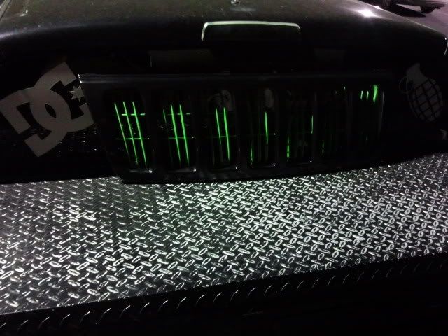

Installed 3 under cabinet lights from home depot onto the tailgate. Tapped into the wire for the license plate light so no wire fishing etc. Works great, looks factory. Used a rocker switch from Advance Auto.
http://www.homedepot.com/h_d1/N-5yc...splay?langId=-1&storeId=10051&catalogId=10053
used those lights
