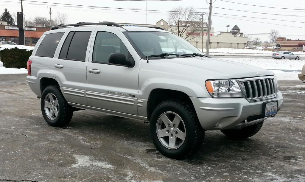

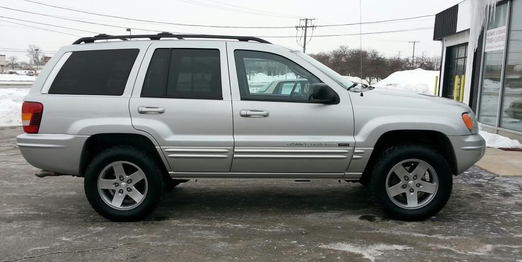

Here's pics from the bb I installed yesterday. 2" Crown/Rough Trail, 245/65-17 Nitto Terra Grappler AT
Rear links are too short and it rides tight with the Addco rear bar. I just measured and 3" links will fit perfect at 12“ in length bringing it back down to stock geometry. Other than that it rides just like stock and I'm totally pleased. Just wish my lifted zj rode this well lol..
Edit: forgot to mention I'll probably need an adjustable front track bar. The axle shifted to the driver's side about a half inch.

I have the same issue. Need to get a track bar. Gonna have my buddy fab up some link spacers out of solid stock aluminum to drop the stock link bracket 2in. like I have seem some do on here. Do you have any tire rub on bumper cover or the inner fender shields?

Yeah I wasn't expecting to need a track bar at all. Found Zone Offroad rear 3" links for $40 I'm gonna to try. Don't want to rip the link mounts off the body with that addco bar. No rubbing that I've encountered yet, although my tires are just shy of 30".

The zone extended sway bar links won't work with the addco rear sway bar AFAIK That's why people use extenders.

Why won't they? That's what I run.
