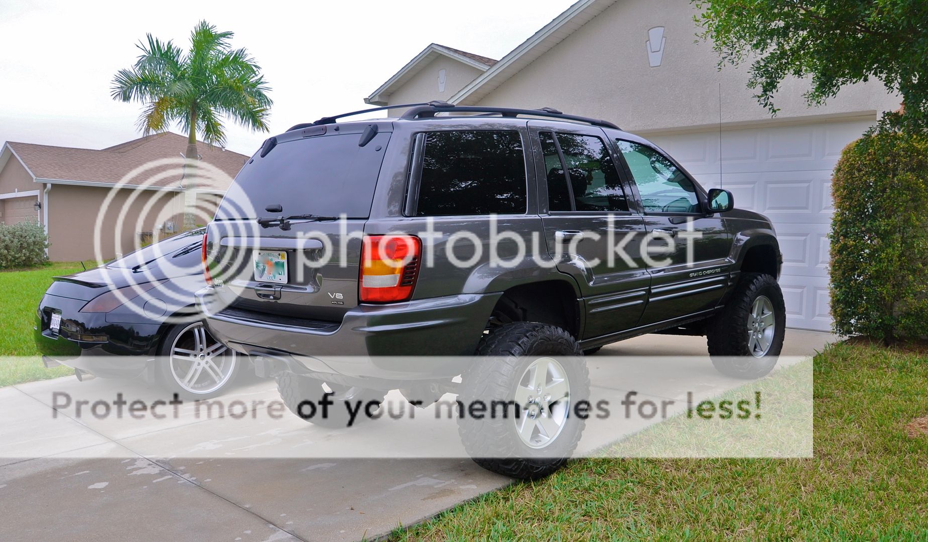

Originally Posted by north50 View Post
Pulled it out of the garage after finishing the 6" Clayton lift. I have a slight vibration in the front under load, should just need to adjust the pinion angle. Also I had flushed the front diff and put in new fluid (Mobil1 Syn 75W140 and the mopar modifier) but thinking it needs more modifier added because it feels like it is locking up a little. I used 2.5oz of the modifier as suggested for the Quadradrive front axle.
Surprised it fitted in that garage!! Really looks like you got the full 6 inches.....unlike a lot seem to on here. Look great! Yeah add the fm little by little to see if that sorts it. Sort the pinion angle first just in case thats adding to the locking up feeling.
Ughh! Why do you do this to me. I settled on 4 inches but when you post something like that... it makes me want to go big or go home!
