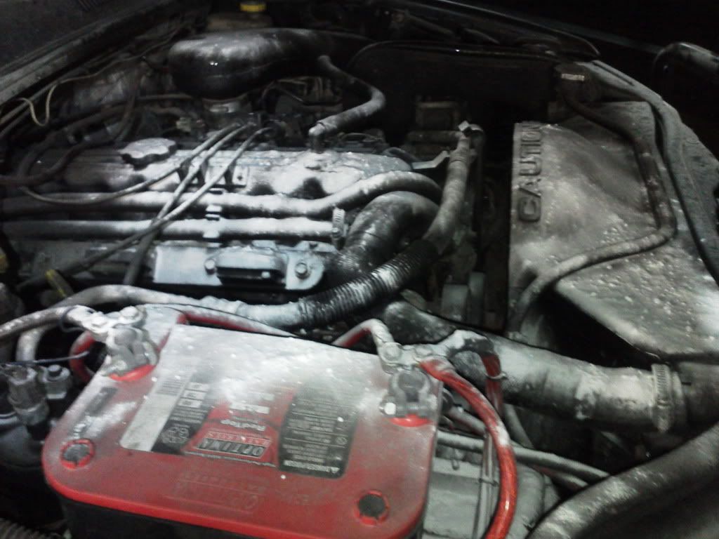

Attempted to charge the battery. An hour after putting it on charge I found the battery smoking and acid all over the engine compartment. I have no idea how or why it happened. Only thing I can think is that the smart charger was having a brain fart. So, in order to not have the acid eat my jeep, I got the luxury of covering it all with baking soda, then flushing with water.
Good news is the jeeps battery cables were disconnected (only winch and amp hooked up) and the battery is still under replacement warranty and I was able to upgrade to a yellow top at no extra charge.
I'll be pushing it out and power washing it all tomorrow, yay for me.

I hear you require an additional battery to charge Optimas....hooking them up in parallel....cables to second battery....
http://www.optimabatteries.com/us/en/support/faqs/ < -----Click on "how do i charge a deeply discharged battery?"
Autozone has replaced two OPTIMAS for failing to properly charge our REDTOPS...thus replacing them for free...

That is correct. If you don't have a battery charger capable of charging agm batteries. My charger is designed to charge agm's and gel cell batteries.

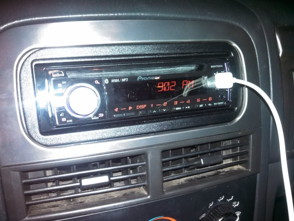

Oil change yesterday, radio today (pioneer deh-x6600bt) and plugs tomorrow. Good days.
