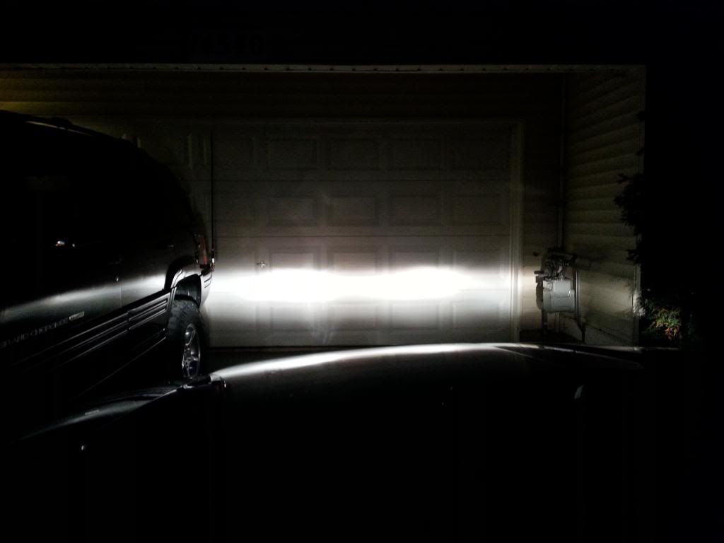

Put in Philips 9012 HIR2 bulbs to replace the low beams. They're brighter and whiter for sure. I no longer need the fog lights on all the time like before. I'm not to keen on the beam pattern though. You can see in the pics below that it's not a capped bulb like the OEM 9006XS. We'll see how it goes but so far no one flashed me. I had to modify the tabs for them to fit which was fairly easy. The hardest part was getting the actual headlamp housing out and even snapped a tab. I learned my lesson after the first one and sprayed wd40 on the other tabs and greased them per WJJeeps.com recommendation for easier future removal.
Against the garage door the one on the left is the hir2 and right is oem. Kinda hard to see the difference in this pic though.
