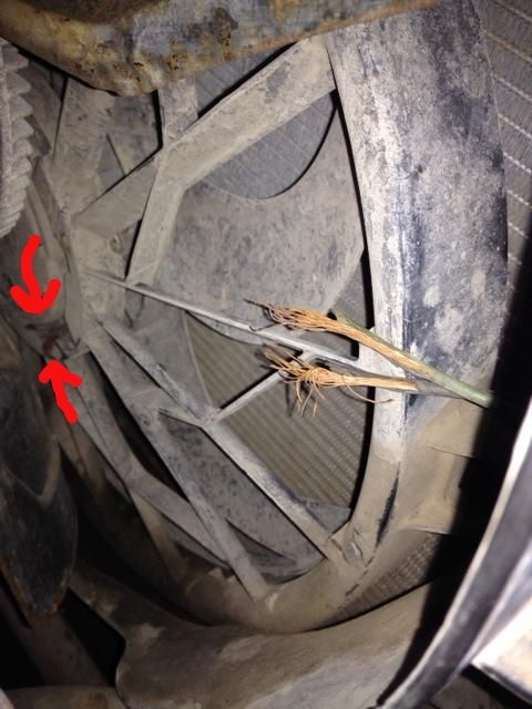

Found out why my electric fan isn't working.... my mechanical fan ate the wires:
The red arrows point to the wires connected to the fan motor. They are currently about 1 inch long.
I was hoping I was just going to have to replace a fan relay, but now it looks like I need a new fan and harness.
Anyone parting out a WJ and have an electric fan/harness/shroud that they want to get rid of?

Originally Posted by CrazyWalnut13 View Post
Found out why my electric fan isn't working.... my mechanical fan ate the wires: The red arrows point to the wires connected to the fan motor. They are currently about 1 inch long. I was hoping I was just going to have to replace a fan relay, but now it looks like I need a new fan and harness. Anyone parting out a WJ and have an electric fan/harness/shroud that they want to get rid of?
You might want to check the classifieds section.
