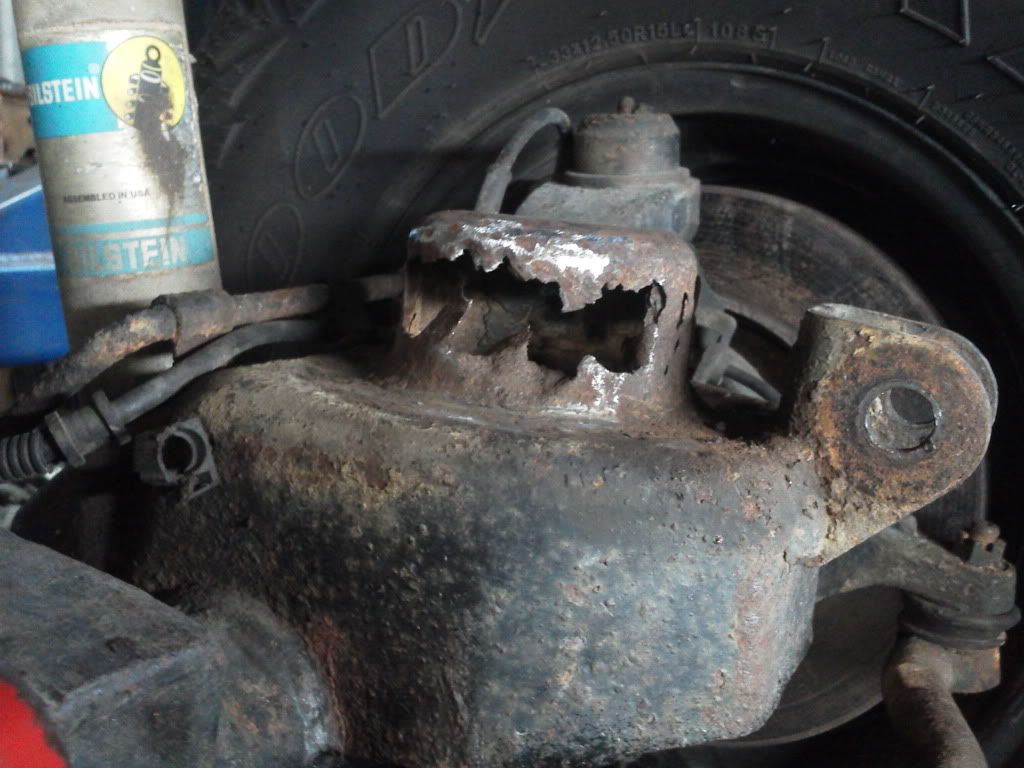

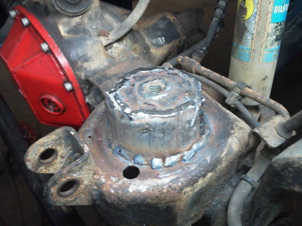

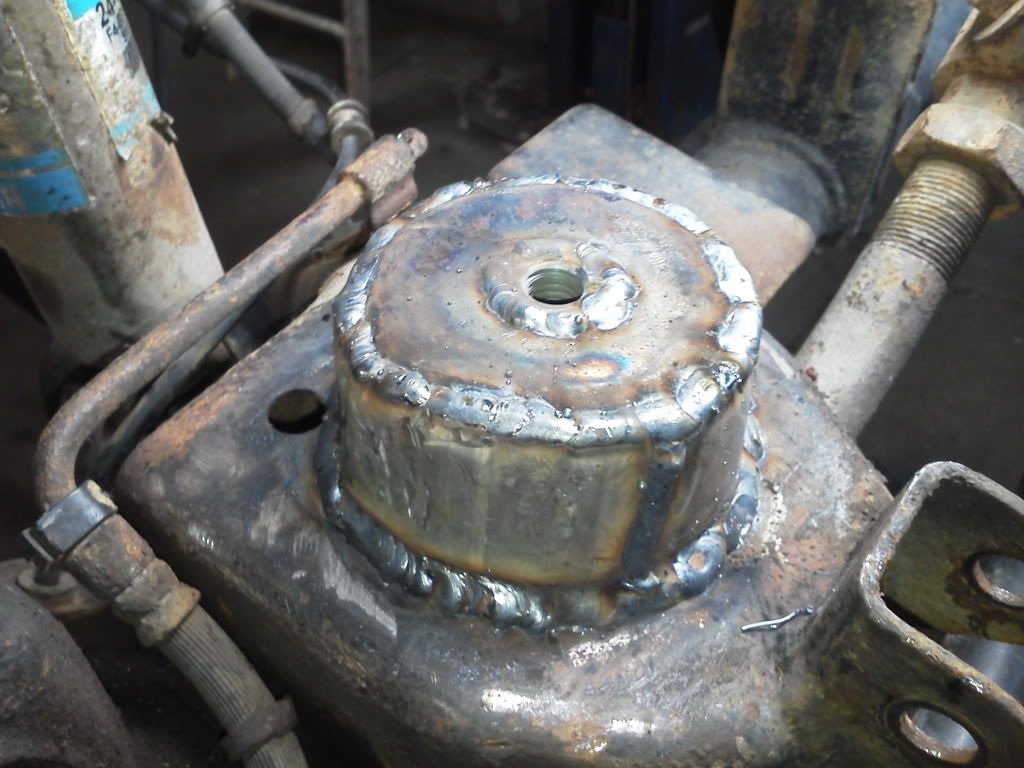

built new coil spring post's. Got a small suprise when I removed the coil spring to weld in nuts for spring retainers. Holes!
driver side
Pass side
took all of 3 hours time and saved me 70 bucks or so by fabbing them myself instead of getting IRO's. All they cost me was some time, welding materials, and 10 bucks for a foot of 3" exhaust tube.
