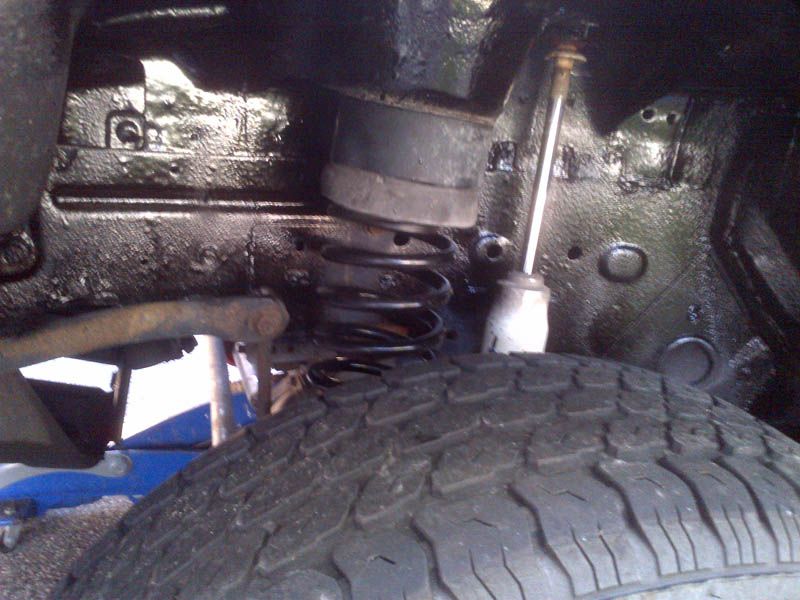

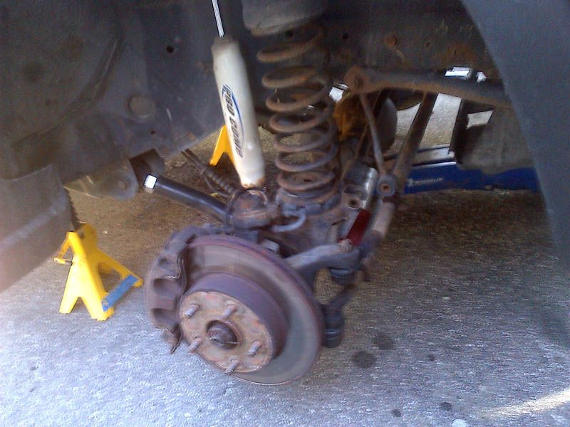

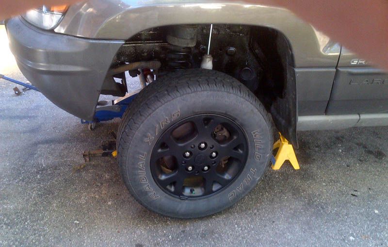

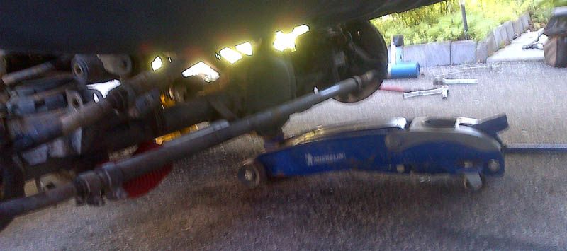

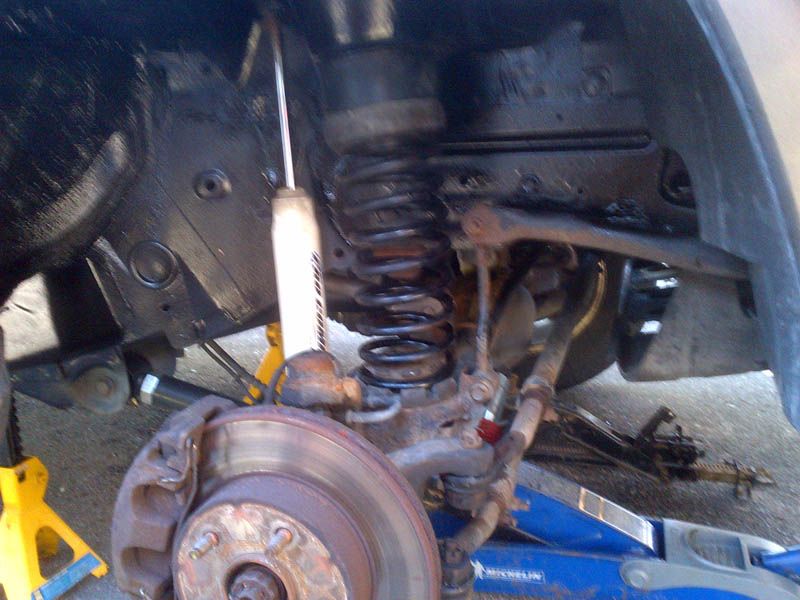

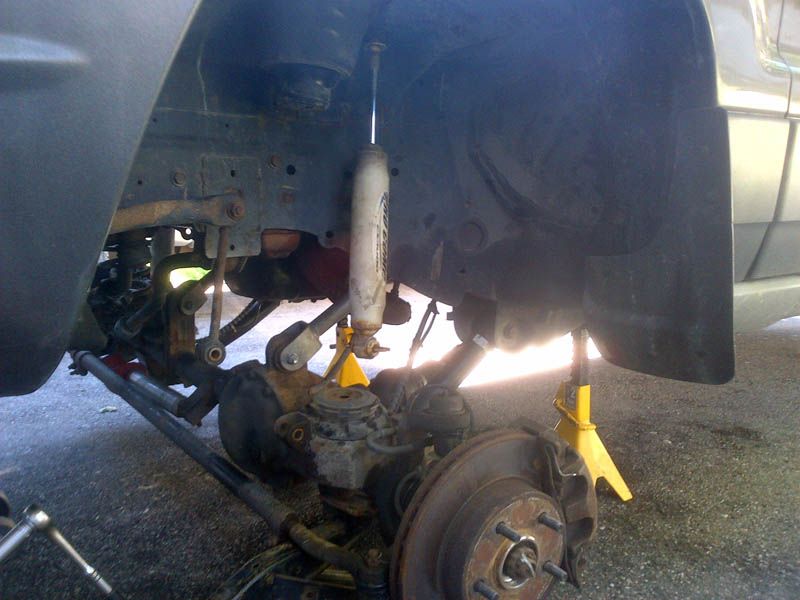

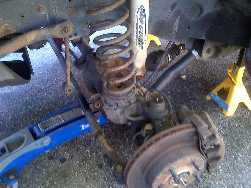

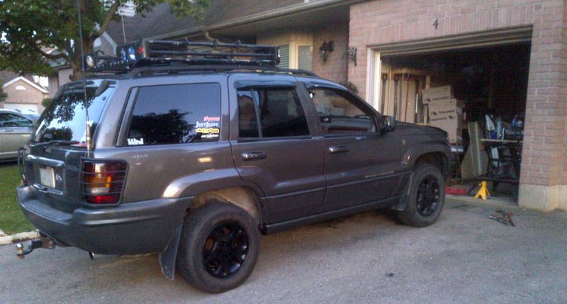

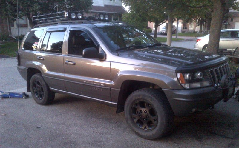

Well, was productive although back springs still need to be changed out. Front feels a bit stiffer (in a good way) in the front. Also rubber undercoated the wheel wells while in there. Funny thing is I couldn't get the jack out at all once I lowered the axle down due to the new control arms and how much flex they give. Drivers side spring came out easy. Passenger side had to use the spring compressors though to get them out. There was no tension but just not enough room to pull them out without undoing the track bar. I really didn't want to **** around with that, so compressors it was. Cleaned the springs and gave them a fresh coat of paint to try to keep the rust off, not that here was much to begin with on them. Ended up using low gloss black engine enamel for the rims. Matte I don't think looks right, and high gloss I'm not a fan of. Took well to the rims, and dried fast which was nice. Now to let them cure and see how they stand up. Was talking to someone where I bought it who used it for his and said they've stood up well since he did them earlier in the year. We shall see. Eventually want my rogues refinished and put on, but these will work in the interim. Also FINALLY painted the rocker cover to match the cladding. It's been driving me crazy I've not done it yet.
So here's the pics I took The one with the jack stuck under the pumpkin I just found funny. Then it's time to throw something on the bbq. I'm hungry now!

What did you use to paint your cladding?
Build Thread
99WJ539918 is offline
post #24252 of 44172 Old 09-08-2013, 08:15 PM
cykaaro
Location: orangville
Posts: 2,841
I only use krylon for plastic on any jeep I've had. Bonds to it so it won't flake or scrape off. Has always worked amazingly so no reason to try anything else. Only mistake I made is using it on the bumpers as they're limited's. On paint it will come off. Eventually will switch the bumpers to proper colour limited ones. Just haven't found yet. Need the front one for my setup, so want the back to match. Always hated the damn bumperettes.
