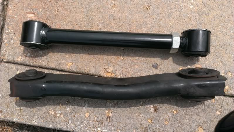

Installed my IRO adj LCA to match the IRO uppers.
One word: Beefy. Much heavier than the Crown and OEM arms. All i needed was a small pry bar to rotate the axle to slide the bolts in. My electric impact wrench helped big time.

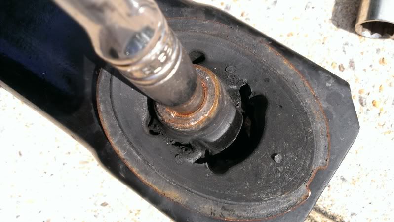

Here's what my Crown bushings look like with less than a year (who was the genius engineer to made oval bushings?):

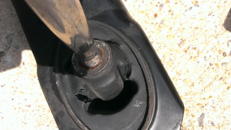

Other side:
What a difference they make. NO more bump steer, no more dead/numb center of steering, tracks nice a straight right over potholes. I lengthened them to 15-7/8" to increase caster. I have very-very slight driveline vibes (i think) at 50+mph. Im going to pick up an angle finder to check the pinion angle. FYI i have the factory Double cardan/cardan front DS.
Nice! Just did mine. Feel the road a lot more I find, but nice my axle isn't moving in ways it shouldn't. Mine were the originals though and were pretty worn, especially on the one side. Weren't ripped like yours are though. That's pretty bad. No more vibrations through the steering wheel etc I was getting. Still have some steering issues I have to fix due to the arms being bad though.

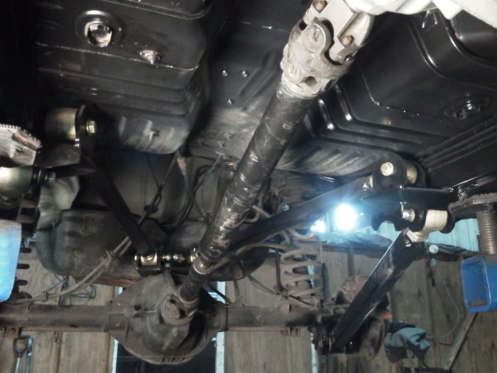

Installed my double cardan rear driveshaft

Im very happy with the results. These have rubber (clevite?) at both ends. It doesnt feel harsh at all, but yes you do feel the road more. I have never felt dirveline vibrations before so I dont know how much is too much.
where did you get that rear driveshaft from?

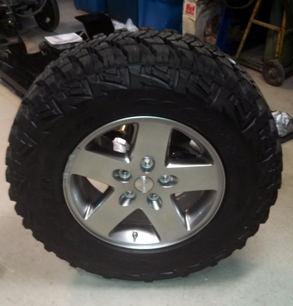

4. Some JK rims with New Goodyear Kevlar MT/R's
