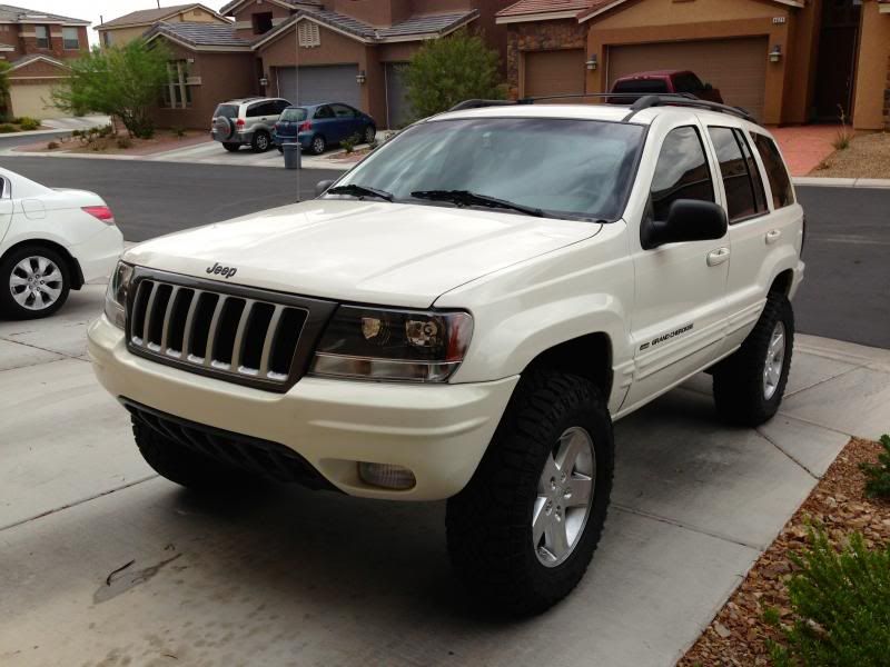

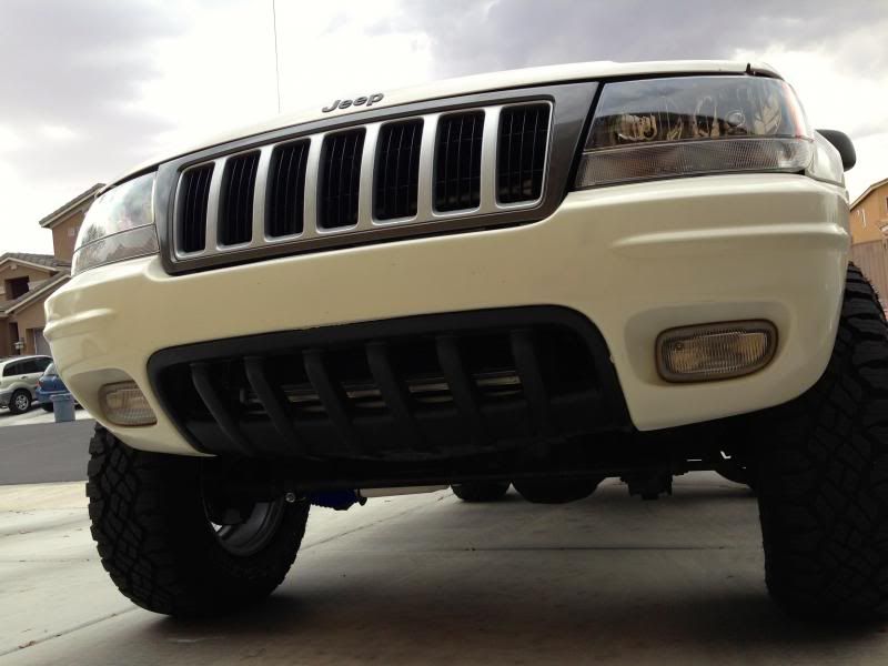

Plasti-dipped the front grill outer bezel...
My girls said it reminds them of a panda bear so I've named the Jeep 'Po' after Kung Fu Panda...the Panda Jeep LOL..
Looks very similar to mine, except I NEED your front bumper! I am doing an 04 front end conversion and have everything except for the 04 bumper (not sure what to get since I don't know if the eBay ones are just refurbished OEM or low quality aftermarket or if they're decent or what OR if I'm better off getting a used one that will be OEM but a decent bit more expensive and used, of course). Can't wait to have that exact setup on my front end.
I too have the 04 Laredo style lights and a grill that looks just like yours but it's actually off an 04 dark gray WJ. Was going to Plastidip it but the metallic grey OEM paint looked good and almost black anyway.
BOT: I ordered some LED strip to do undercarriage lighting (that comes one when I open the doors to illuminate the undercarriage when I get out of the Jeep at night, and for when I'm trying to look/work under there at night). I also recently ordered the cheap door panel clips and replacement chrome "Jeep" badges from JGCParts.com and they are GREAT! The door clips tightened up my door panels completely. I just don't know if they're re-useable since the style of clip they are seems like it might be hard to remove and they might get ruined if you take them out. A pack of 10 costs the same as the Jeep charges for 1 of the stock ones, and these are better and get the panels progressively tighter the more you push them in.
Highly recommended to fix door panels that aren't completely tight. Now my inside rubber weather seal doesn't try to slip between the loose door panel and the window. As for the Jeep emblems, they seem decent quality and they have a more chunky modern look. Not drastically, but they're a little thicker (meaning they stand further off the surface of the hood/tailgate) and have a slightly blockier look with beveled edges. They look good but aren't installed yet.

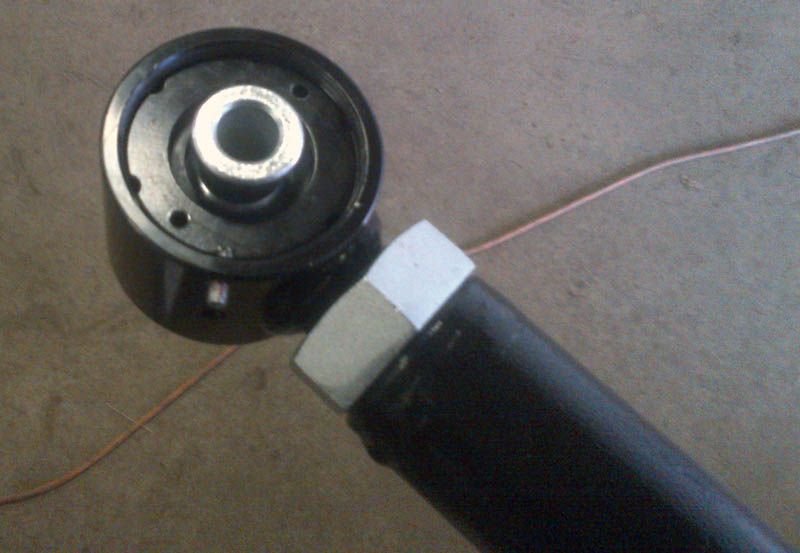

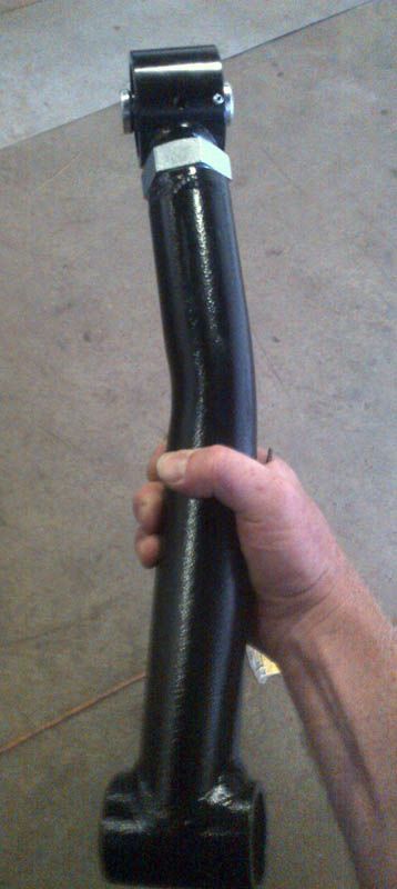

Got the new RC front LCA's in yesterday. Huge difference. No move weird vibrations through the steering wheel, no shuddering when braking hard at highways speeds. Feels like a whole new truck. The other thing is the whole front feels really tight now, and can feel the road like my old XJ used to do.
The flipside, is the steering is definitely a little off. Have to straighten the steering wheel as it's slightly turned to the left. There is a little bit of play, and when you turn the wheel just a small bit left or right it starts to turn considerably. I know something is off but not sure what. Everything we checked seems tight without play? Maybe should just start replacing the TRE's regardless and start there? Any ideas? At least it's not wandering like it did though, especially at higher speeds and in windy conditions. Now to track down the last which is the steeriing not being quite right. Definitely not the pump as it was replaced in december and have another steering pump (I believe it works) and intermediate shaft, just in case.
Look beefy! Just curious, why did you go with RC? I hadn't even really considered them for adjustable short arms because I figured the IRO's for about the same price (or less?) must be better. But after looking at them, they seem fairly decent and they use Johnny Joints, right? Just wondering why you went with them over other options and what your take is on them. Thanks.

Wow, they look good. Even offset a bit to accompany wider tires. I ordered some IRO adj LCA's to match the UCA last week. How much did you pay for those?

Have RE uppers, but they don't make anything for the WJ. I've only a 2"BB and although the stock ones were fine, mine are worn, and the driverside was brutally bad. I like the idea of them being rebuildable and if I ever go a bit higher, they're already in place. I went with the RC for a number of reasons. They are readily available to order through a local place I use for parts, such as these, and the price is in line with stock ones. Got them onsale as well so cost me $185. Stock are $110ea and even at regular price they were $199.
So far no issues and the axle is performing properly now compared to how bad the bushings were, even more so on the drivers side. The biggest thing I find is that it really has stiffened the feel of the front really noticeably. Probably due to the design/poly bushings and how bad the original stock ones were. Second day on them, and it's feeling a bit smoother as everything adjusts.
Can still feel the steering is a bit off, but doesn't wander or as bad in windy conditions on the highway as it was before, and braking at above 80km/h is now normal again. So far so good. After I get a few hundred km's on them, we'll see how they feel.
Next will be looking at the steering and seeing how to get that to feel right. Just feels way to touchy, as I have a bit of play in it, but if I turn just a little bit left or right, it really turns quite a bit. Not sure what's up. I some a couple of the TRE's where done when I first got it, but not sure what might be off, as everything seems tight. Will probably start with the on on the pitman arm as there's a small tear in the boot, and the tierod one on the drivers side.

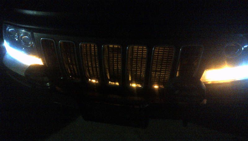

Got a couple from last night.
Red light strip and logo from front doors.

Very Cool
I got to have some of those LOGO lights.
Where did you get them?
