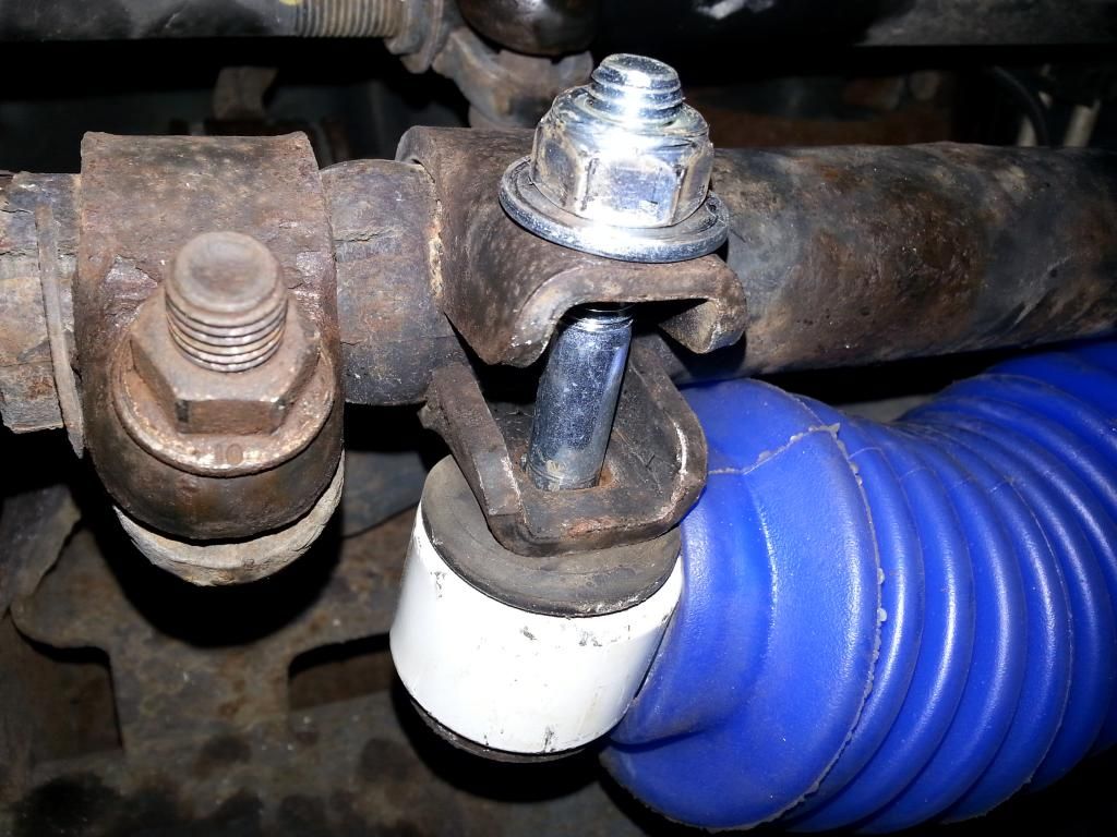

For some reason my pic didn't show up. The end of my moog SS didn't fit in the same place as the original SS so I just bolted it too the side of the bracket.

Installed my Moog steering stabilizer on my 04' WJ SE today. Does this install seem legit?

Any possibility you could upload a picture larger than a postage stamp? It's difficult to see what's going on here.
Let's try this.
yea thats right...i'm on my 2nd aftermarket stabilizer and that is how i mounted mine..since they are bigger than factory the don't fit.

Let's try this.
Looks good! I thought there was a washer between the ss and the bracket?
I think there should be as well. I had to go out and buy a longer bolt for mine.
The other thing you might want to do is turn that clamp towards the rear a little which will keep the stabilizer in line with the other suspension components. I was told that they don't work as well when they are at that that angle.
