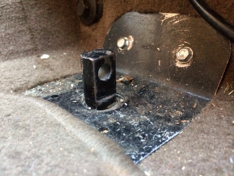

Hey I've searched the web for what this is but to no avail, but there is this air tube that comes out from under the drivers seat on my wj and it looks like you could connect it to another air tube or pump if you wanted. I don't know what it's for, but I'm assuming it is something for the seat? Anybody else have this in their wj?
Here are some pictures of it:

Here is a pic of the other latch thing, it doesn't go to underneath the car

Size:  349.4 KB EDIT: Followed a different tube from the cylinder thing and found it goes to the plug in unit for when it's being towed. On the side of the cylinder are the words BRAKEaway. I had bought it from a guy that had towed it behind his rv a lot and so I'm now guessing that the rv had an air pump that pumped air whenever it braked and the air would go to a mechanism that was latched to that latch thing and the mechanism would press on the brake pedal.
