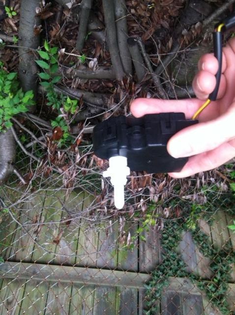

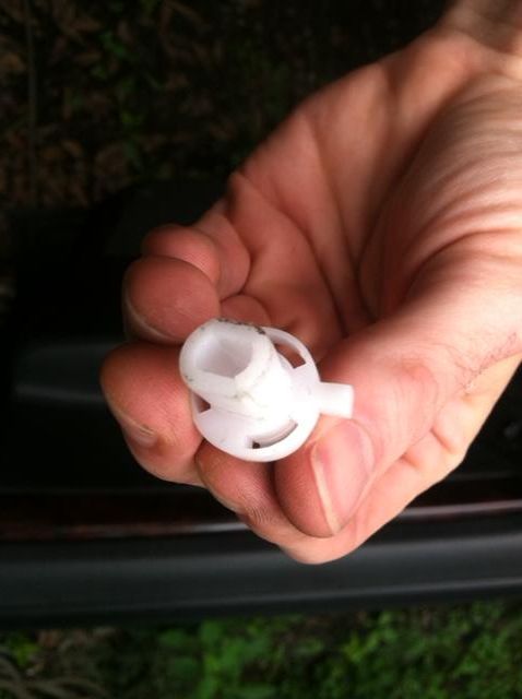

Just wanted to post an update. I pulled the actuator behind the glovebox and the shaft going into the blend door came out with it. :bigeyes:
Apparently, the new (aftermarket) actuator put too much pressure on the white plastic piece and broke it. Fortunately, I was able to pull the one off of the old blend door, swap it in, and plugged in the OEM actuator and all is working for now. Here is a pic of the broken plastic shaft.
First time I have seen a broken actuator. Be happy it was on that side :-) Glad you got it fixed.

Seriously. The actuator wasn't broken, I believe it just placed too much pressure on the plastic blend door shaft and broke it. The bad thing is that the same aftermarket actuator is also on the rear door. Hope it holds up!
A couple of months is not long for the blend door shaft to break. Did whoever replaced the blend doors give a warranty, or did you do it? That's why I went with the aluminum doors and shaft :-)
