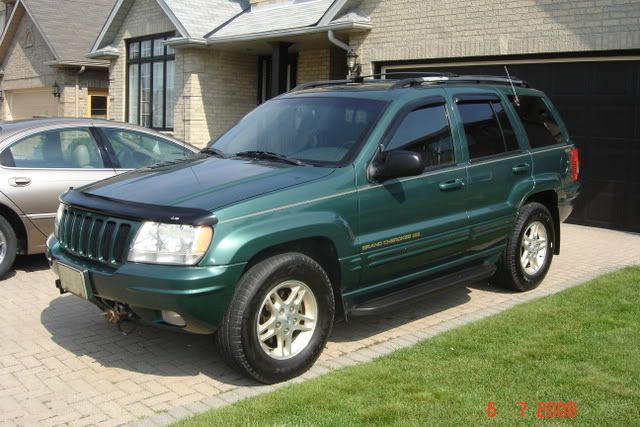

I was considering buying this Jeep that had been towed behind an RV. Guy said the last owner said 60,000km was in tow so the odometer doesn't reflect its operating mileage. If the odometer doesn't roll, then buddy may have been lied to. Hmm.
Anyway, you can see the setup on this one. I like it because it's pretty hidden in there. But I don't have a clue what brand it is.
(Sharp lookin' '99 too, eh?)
