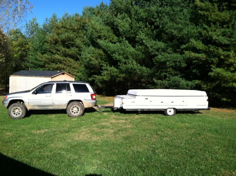

So I wired in the trailer brakes last week and pulled the pop up along with the WJ for a weekend long trail ride. I noticed immediately that the rear squats quite a bit when pulling the 3500 # dry weight PUP. My rig uses the RC 4" springs in the back and was wondering if anyone has used the "Air Lift" helper bags? Did they help? What was your experience?

While these are valid concerns the pop up I am towing should have a young weight far less then 350. I believe it is due to the fairly flexy springs the RC lift comes with. Has anyone tried the add in air bags?

Here is a picture of the setup with the load. The back is about 2" lower then normal.

The Commander was an example. The question was about a WJ. I am having a great day! I solicited information about towing helper bags. Please read my original post. EDIT: Do you tow with a lifted WJ? What? Here is a picture of the setup with the load. The back is about 2" lower then normal.
Bags work - yes, they'll make it ride level and are probably cheaper than a WD hitch.
However, I agree with others.. the WD hitch is the way to go. I have a 4" RCX on my WJ and it sits like your picture without it (I also have a PUP). With the WD hitch it sits pretty and level. BTW.. it sat that way with stock springs too. Don't blame the "Soft RC Springs" for that sag as it's normal.
U don't have to pay $500 for a WD hitch. The benefit of this is that it distributes the weight to all 4 wheels, lowering the stress on the rear end, transmission, suspension, and your ride in general.
Sorry, my two cents.

WOW you werent kidding about the sag. I really like the idea of bags as a cheap fix to the sagging problem. If you get them don't forget to report back on how they do!
