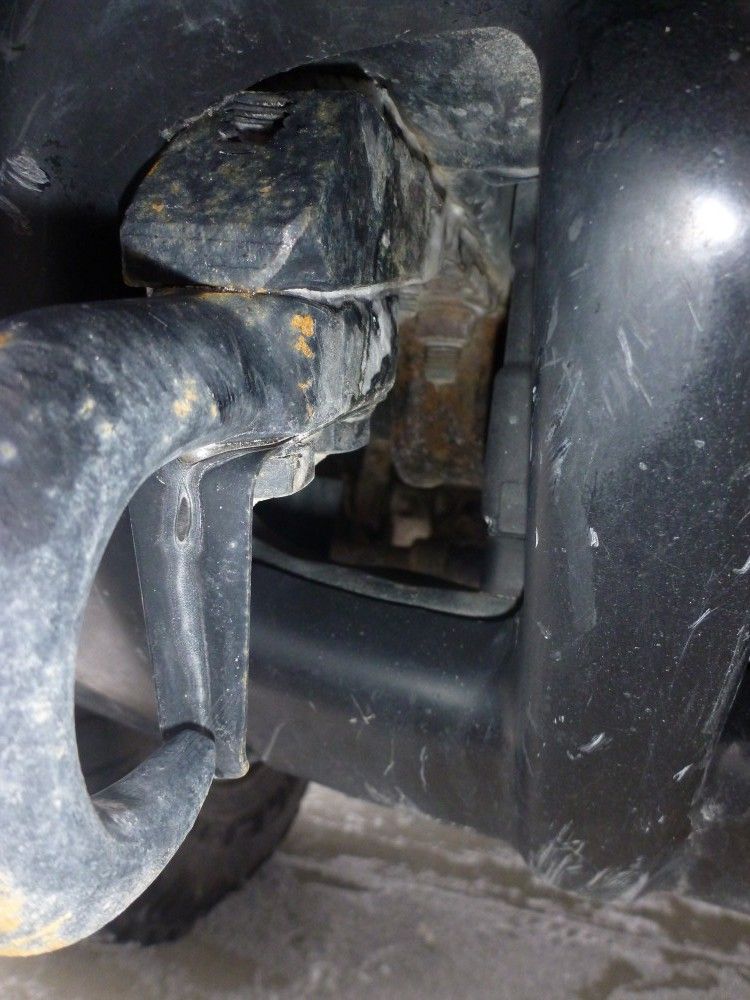

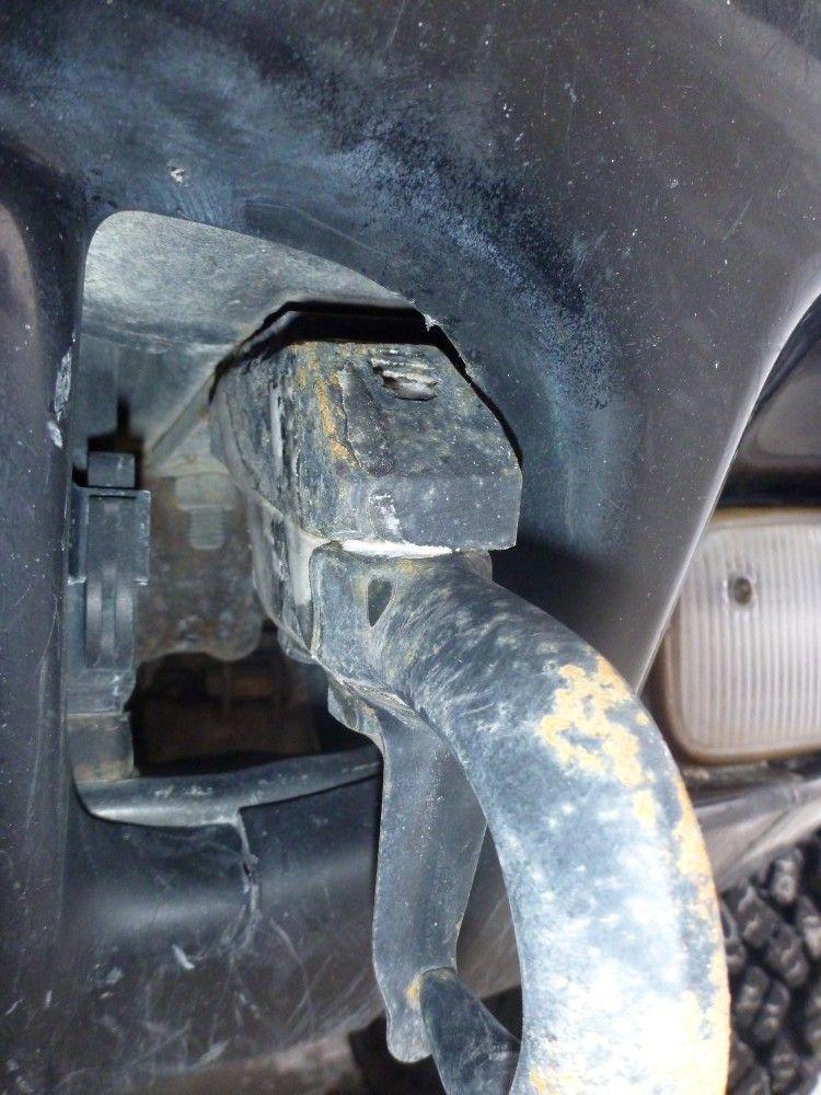

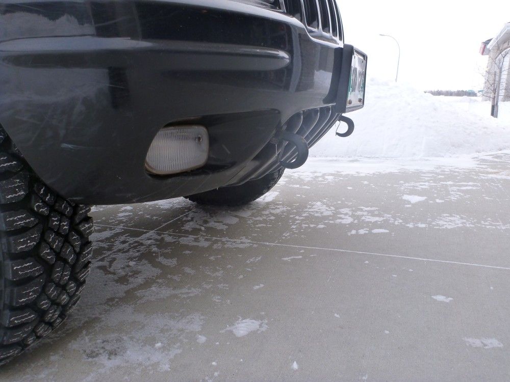

I did the same budget hooks when I couldn't source the OEM ones, to be honest this route gives you way stronger hooks (rated to 10,000lb vs the OEM 6,000lb). However, to protect the unibody we added some agle brackets inside the unibody rails so when we bolted it all togeather the stress was spread across multiple points on two planes of the rail. Much more robust than that weird OEM setup tripod thingy.
Apart from that, while my friend was helping me with this he also made some risers to lower the hooks out of the way of the facia, bring them forward somewhat, and add a little angle to them. The end result is that I slightly scrape those hooks on steep inclines before causing any real damage to the facia or radiator support.
This should give you an idea of the risers that I'm trying to describe:
Note: Next time the facia is off, I'll take some pictures of what I did on the inside of the rails.

Here is a better picture of those risers I talked about, sorry for the 1.5 month wait.
