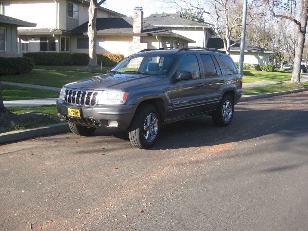

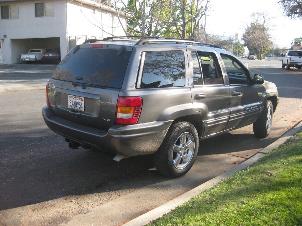

Got some daylight shots, but forgot my memory card and had to use my phone instead. Oh well. I am also selling my stock rims/tires, upcountry springs, stock trackbar, lower control arms, and rear shocks (front shocks did not survive the install :P). PM me if you're interested.
before:
after:
before:
after:
