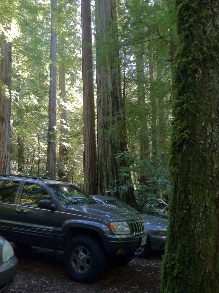

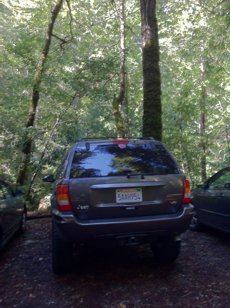

Today we took it up into the Santa Cruz Mountains to Big Basin Redwoods State Park. I used to camp here as a kid, and it was nice to really test the Jeep on those real narrow single lane switch-back mountain roads. It did awesome, and I was wishing I could've done more exploring up there, but we mostly explored on foot.
Anyway, I do have some up-to-date pictures now.
I love Redwoods.

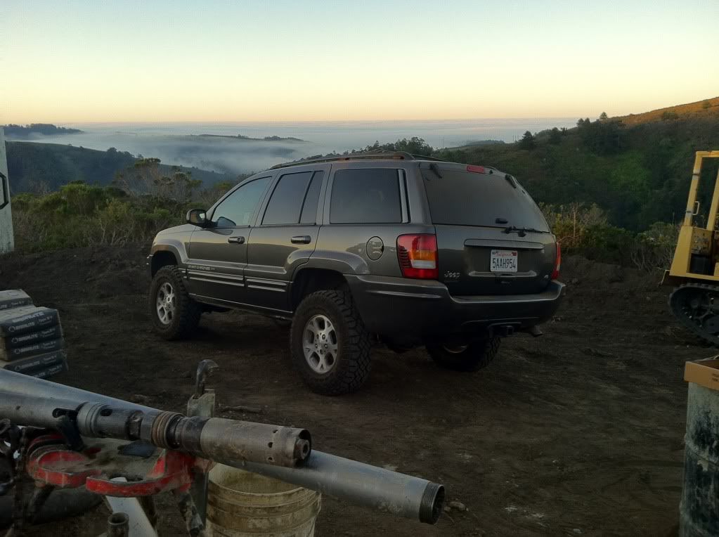

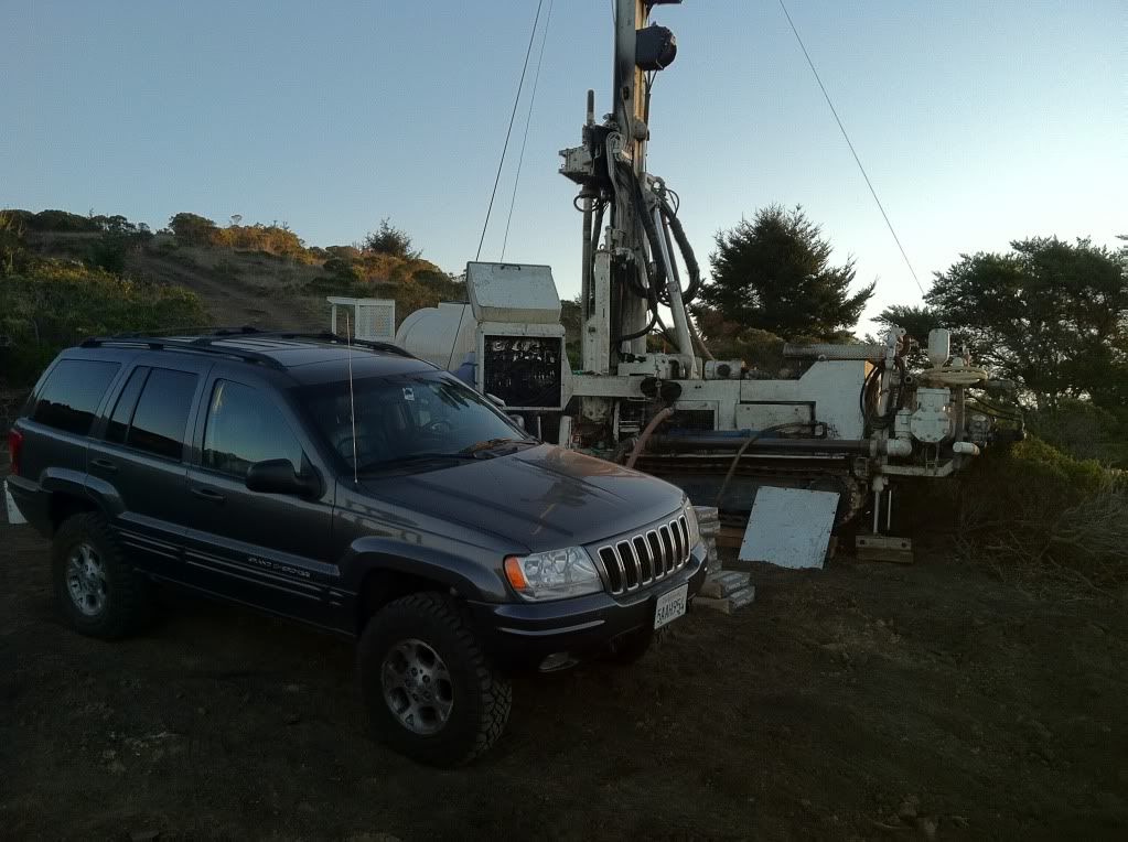

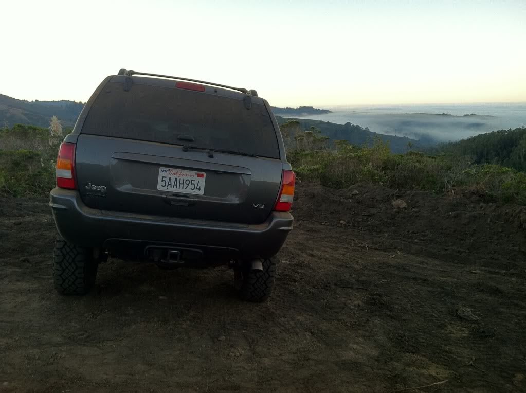

A few months ago I had to use my jeep instead of my company truck to get to a remote jobsite that required 4 wheel drive. The client used his dozer to make a "road" for us, but it was pretty cool to be off-roading while on the clock!
Most of the time I was able to borrow a co-workers 02 tacoma 4x4, which did pretty well for a stock truck. But my WJ did circles around it, made it look like a toy. I know it's apples to oranges, but it still made me feel good about my jeep.
Anyway, I got some pictures and video from that 3-week long adventure.
