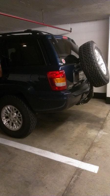

The roof is a "decent" option, and you could either buy a basket and secure it to that, which I've tried on other vehicles, you lose the majority of your basket storage space. KOR (kevins off road) has a decent option that is only a tire carrier. That being said, I had mine on the roof thinking A) it looked kinda cool, and B) "even though it will suck to get off the roof, when will I ever actually have to do it?". Murphy's law is everywhere, and the one time you'll need that spare, it will be raining, dark, you will be by yourself, and there will be steep hills on every side of your WJ. Where are you going to throw that thing?
If you have a hitch, and if you don't, you should get one anyway... I did this:
http://www.jeepforum.com/forum/f310/...76/index4.html
Paid about $100
-Brian- 2000 WJ Four liter, 4" RC springs; Bilstein 5100s; JKS trackbar w/KOR bushings; Stillen rotors; KOR (RC) 1.5" wheel spacers; 265/75/16 Treadwright Guard Dogs; Rusty AirTube, Amsoil Cone; Thule M.O.A.B.; Bumper delete; rear seat disco

Wow, not too shabby. Just to make sure I'm looking at this right, that's just welded to your existing hitch yes? You didn't replace the hitch? And haven't had any problems with rattling or anything? Any chance I could get you to share the design specs? or are they in that other thread a little deeper? Thanks for sharing.
Yes it is welded to the hitch. I don't have specs necessarily, we kind of just freestyled it, but all of the pictures should be in that thread. Probably further back. Any decent fabricator should be able to replicate it. The only "problem" is it bounces a bit when on rolling concrete highways. Must be the way they crown them... I don't notice it on asphalt. I need new springs and a rear ball joint too, so that probably doesn't help. I'll see if I can find the rest of those pictures.

Maybe take a bike hitch carrier, weld a tire bolt holder to it, make it so that it can swing down when you pull out the pin.
The last carrier is the same idea I had in my mind.
Sent from my iPad using my fingers
That's basically what the picture of above is...
Plus it doesn't address the fact that he wants to retain hitch usage, as the OP said in his last post, which you quoted him on, friend!
