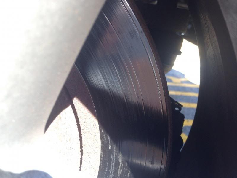

I'm a new WJ guy still...but noticed my brakes squealing a little bit when I stopped at traffic lights.
So, I took a pic. It's below. Both fronts are definitely grooved and I'm pretty sure they should be replaced, right? On the outer rim, you can feel the indentation where the rusty part stops and the shiny metal starts.

Check how much life if left on your brake pads, wouldn't surprise me the squealing is metal on metal and gouging your rotors.
I can't speak for which type or pads to get or whether to turn them or get new rotors. That is more personal preference, but if they are gouged pretty bad it might be best to replace.

It looks like it's time for new ones. Agent620 makes a good point. Squeal is likely metal on metal.
Order some new pads and rotors.

Replace rotors and pads .... Buy parts at Rockauto ..... Many options ..... Great prices.

Yup, I ALWAYS replace the pads and rotors at the same time. It's the best way to avoid run-out and brake pulsations.

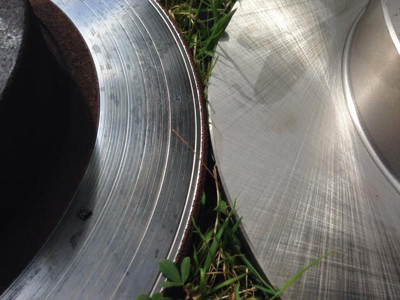

after pulling these off, they didn't actually look too bad...but they were already off and i had the new ceramics...so, I went with it.
looks like the grooves in an old 12" record.
