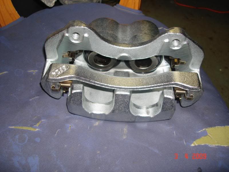

Side by side.
akebono is the shiny one.
picture of when i did mine.
Mounting Brackets ARE TOTALLY Not Same. YOU CANNOT USE ANYTHING FROM THE TEVE'S MUST GET ALL NEW HARDWARE.
PM Kolak on here he gave me a awesome price on the Upgrade with all the hardware to fit my wj from crappy teve's to teh bono's
Kit came with 2x FULL calipers With Pads alrdy installed i threw those away got stillen Mintex pads.
2x mounting brackets
all the bolts
New brake Clips.
And detailed instructions on how to install them by doing this upgrade you can change brake pads in mybe 30minutes since the pads ride on the bracket now instead of the caliper. just pull the caliper off pop in 2 new pads your done.
