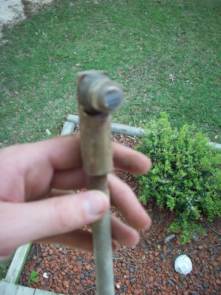

^^ invest in some clevis pins to replace the stock supplied pins.
'02 WJ: 4.7L, 5", HP44/9", 231HD, tall & skinny KM2's
skain8 is offline
post #11 of 15 Old 05-18-2011, 10:46 AM
PhantomWJ
2003 WJ
Location: IE
Posts: 3,811
Attachment 231370
I will have to grab a set...I have had that tape on there since February...
