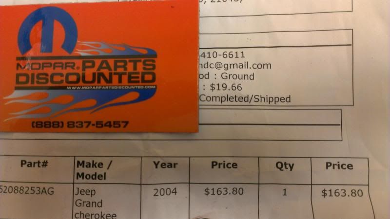

post #11 of 18 Old 10-15-2013, 08:44 AM
Merc1973
Location: Sykesville, MD
Posts: 1,948
Originally Posted by skain8 View Post
If you don't mind me asking, how much did that part set you back?
Online paid about $163.
This is the latest (revised) part number to replace the older one. It took a whopping 5 minutes to replace. I did put some loctite on there since its a crucial part.
BTW, I did not notice any looseness with my old one in my hands versus the new shaft. However when installed, i noticed.
I think that's exactly what I need. Thank you!!
I don't understand how you weren't able to visually see anything wrong with the part that was taken off the vehicle, yet the new one fixed your problem. All it is is two u-joints.
