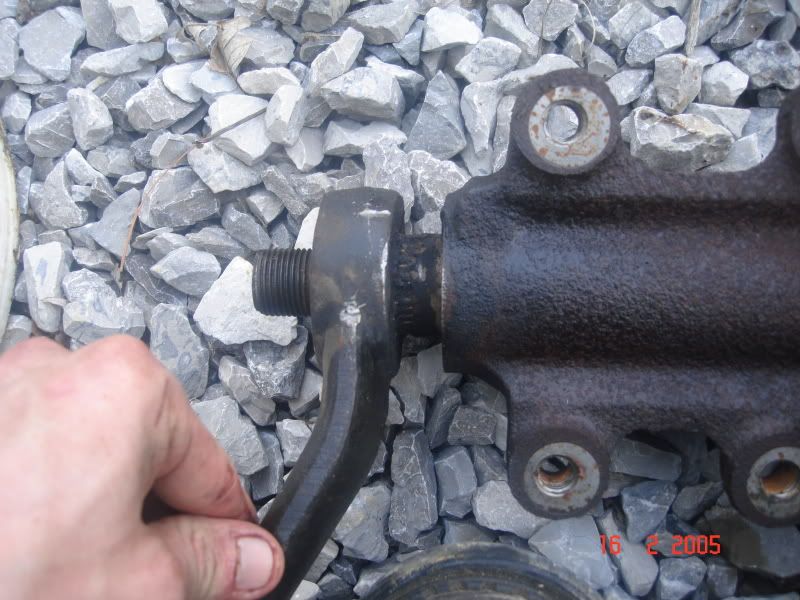

I put a bunch of install pics in this thread:
http://www.jeepforum.com/forum/f310/...times-1152925/
2000 WJ Laredo 4.0 4x4 Taupe Frost - Stroker | Clayton LA w/3" Lift | 33's on JK 17's | Axles next

Great, thank you, pictures do help.
