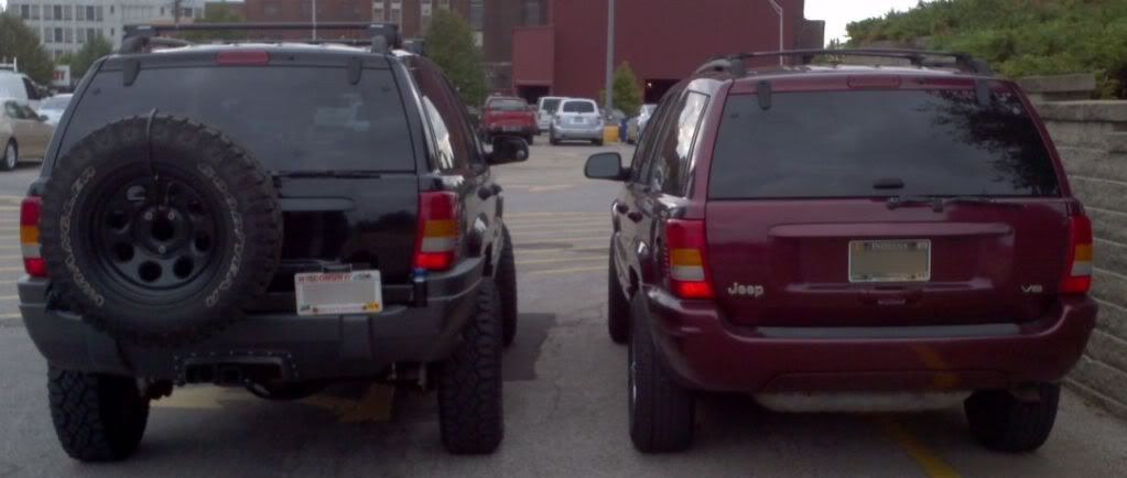

The photo above is a stock WJ on the right, and my personal WJ running 17x8" Soft8's (4.5" BS), with 245/75-17 Duratracs (on 3.5" of lift). If needed, I can run out to the driveway for an exact measurement, but I would guesstimate that my tires hang out beyond the fenders no more than 0.75". It's unfortunate but the photo above is a bit of a forced perspective. Most of what sticks out is sidewall rather than tread. Here's a shot of the same vehicle from directly behind:

I just ran out and measured with a straight edge and a level: The only thing overhanging my fender is sidewall.
Edit: 245mm width tread, on an 8" wide tire, with 4.5" of BS (IOW: +12mm offset). Measured off the rear, since the front fender tapers towards the front.

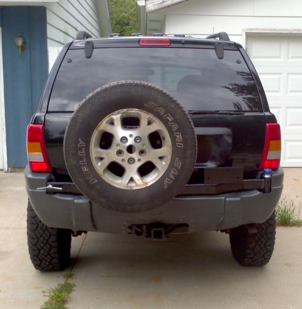

Here are mine without spacers and they are sticking out around 1.25", am using BlackRock Wheel 909B rims which look similar to the soft 8's but aluminum, they are 0 mm offset and 4.5" rear spacing:
Rear
Front
