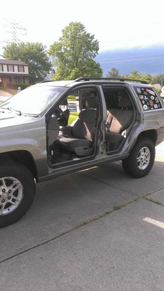

I took all 4 doors off May 24th and put them back on the 26th. The whole time I had them off it didn't rain and all exposed electronics and wires were covered in plastic bags so I know no water got in. That being said, ever since I put the doors back on the door electronics have been acting up. At this point none of the windows roll down, passenger side mirror doesn't move, only the passenger side lock works with my fob and using the lock button on the door, and the trunk is locked shut and I have no way of unlocking it.

Double check you passenger side harness for broken pins or loose wires. Any pics with the doors off?
