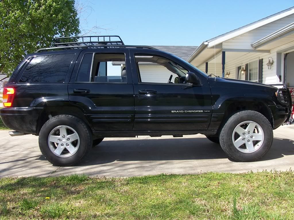

Hope this helps
Here is my '02 WJ with JK Rubi's. The tires are 245/75/17's, which measure to 31.5" diam x 9.65 width. Granted, I have 2"BB AND UC springs. No rubbing at all, even with full flex (sway bar connected).
I tend to think you could get away with 255/70/17's since they are right at 31" diam., but the full 10" width might give you issues in turn, assuming that 31" IS too tall.
Keep in mind that my tires are non-aggressive-tread street tires.
The front wheel well looks tight, but I think it's the light/shadowing.
