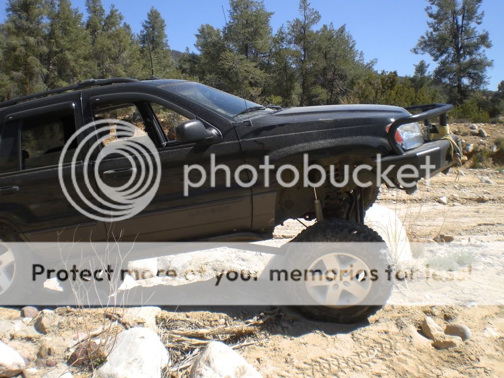

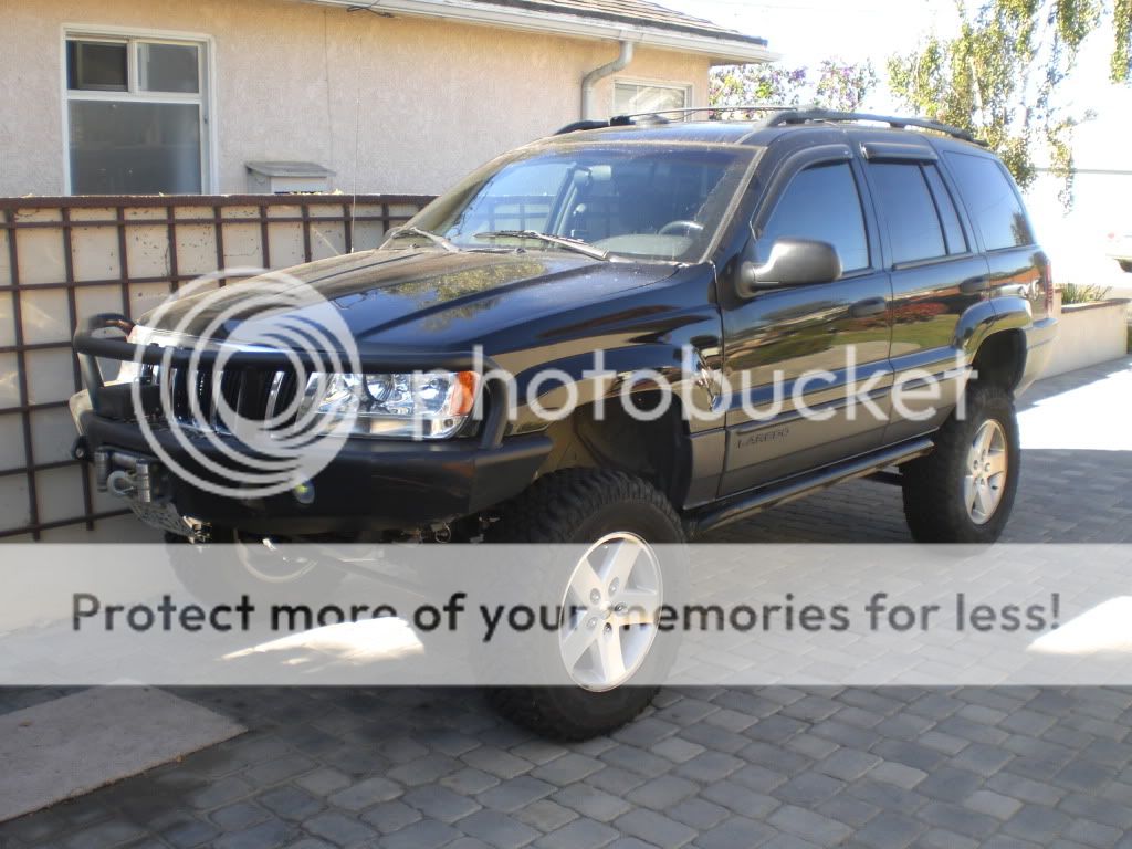

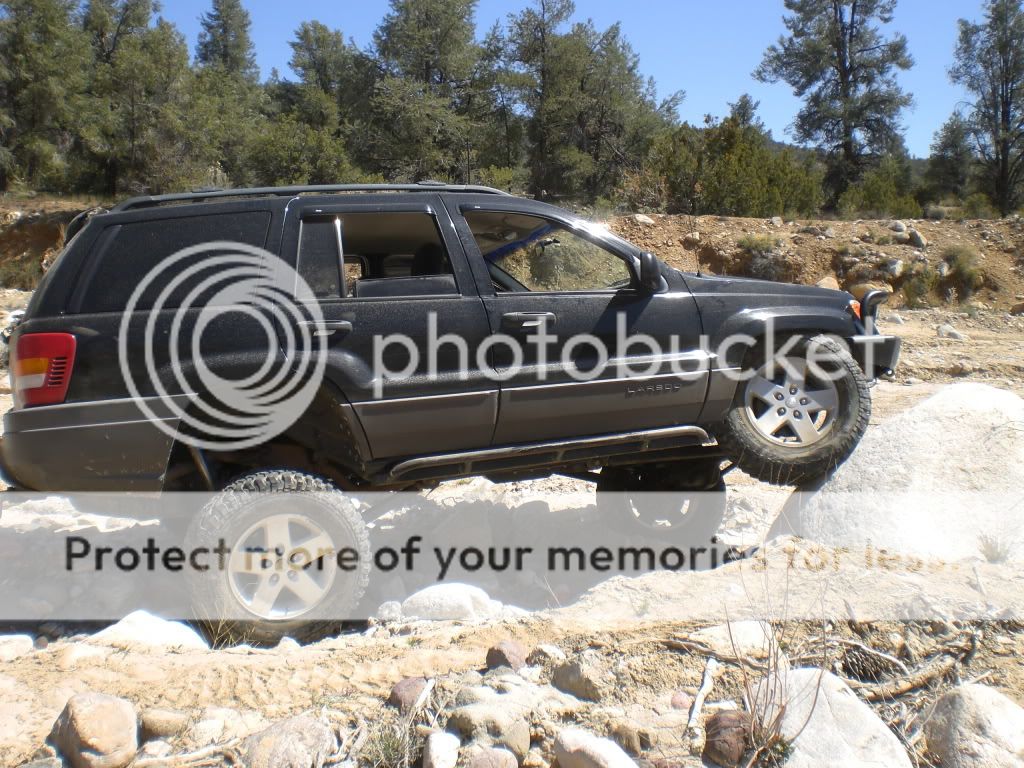

I got these on my WJ, hope this helps, you can get GREAT deals on Craiglist now....Matt

Ok, but you have a 6" lift? What if I just have a 2.5"?
