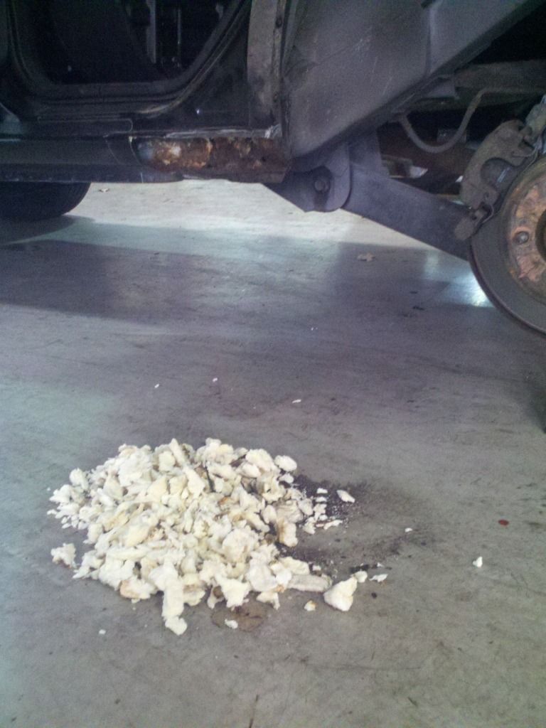

Rocker repair
Please do not buy those rockers. I ordered them 6 months ago to repair a spot on my WJ and the panel lines were not even close to matching. I returned the panel and ordered up the more expensive rocker panel listed on eBay. If you are patching in a section its worth it to spend the extra $ to get a perfect fit.
A few before and after shots. I used black Monstaliner to paint the rockers on both sides and it REALLY looks good in person.

I don't remember the exact vendors name but the drivers side rocker cost somewhere around $150 shipped. It seems to be a factory style replacement part. The curvature of the rocker matches the lines/curves of the one on the Jeep perfectly. If you see an pics of black primered rockers on eBay that's most likely them.
The rocker panel I ended up with could have been replaced as a whole. I chose to repair/section a piece in. So much less work because I didn't have to cut out the whole side from front to back. It wasn't that hard to do. Just take time with welding in the new piece cause the sheet metal is thin and blowing through/warping is a possibility.
