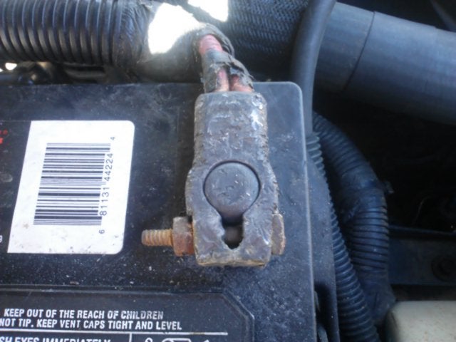

My positive terminal is in bad shape and continues to corrode causing the Jeep not to start and gauges going crazy. When I disconnect and clean post and terminal, then reconnect it starts fine.
If I was to just replace the terminals, would that help my problem? Kinda needing a quick fix til I can make a harness.

This is the positive terminal.
Attachment 1115809
If you remove a portion of cable insulation near the connector you might see corrosion hiding there.

post #14 of 18 Old 02-24-2014, 10:33 AM
lemiller
Join Date: Dec 2012
Location: Naperville
Posts: 194
+1^^^^
That's what I found on mine. So I decided to just run all new wires. But it is possible to just cut off your battery connector and install a new one. I would use marine style or my preference, military style terminals.
