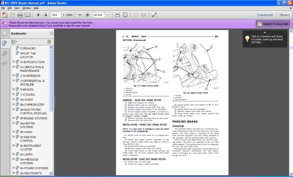

i am trying to remove my rear parking brake cable and the FSM says that you need to remove the caliper, caliper anchors, and rotor...
i was looking at the picture and could you not just remove the rotor (4 bolts i think) and all the rest will just come off???

you have to remove the caliper and caliper bracket, then the rotor will fall off. the pressure from the wheel/lug nuts hold it in place, but the caliper hardware HAS to be removed to get it off.
