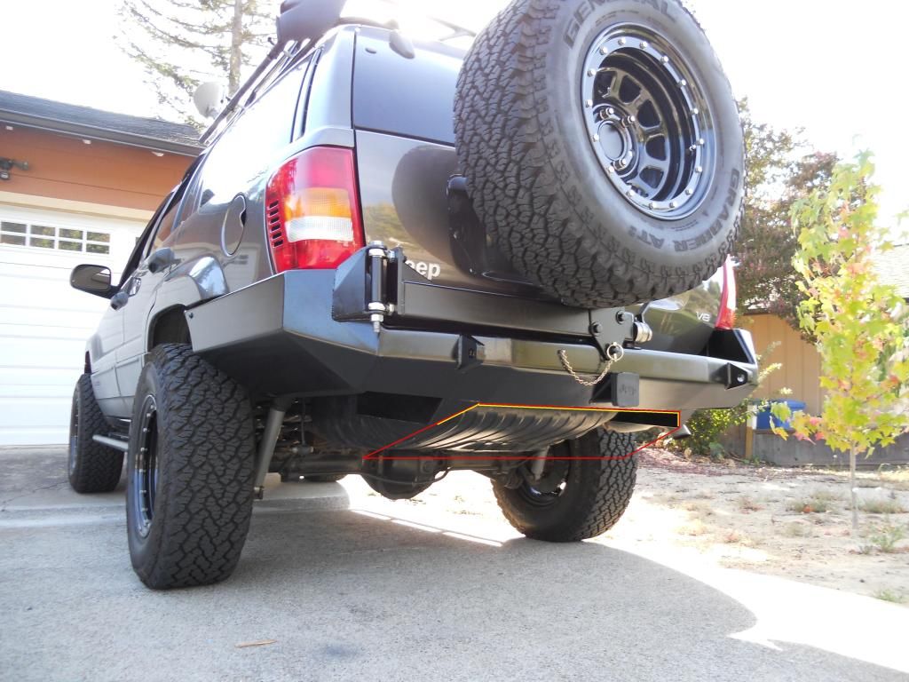

http://photobucket.com/WJProtofabRearBumper
In this last pic, The red shows where the "skid" is and the yellow is where I had to cut it off with a grinder. Only took a few minutes.

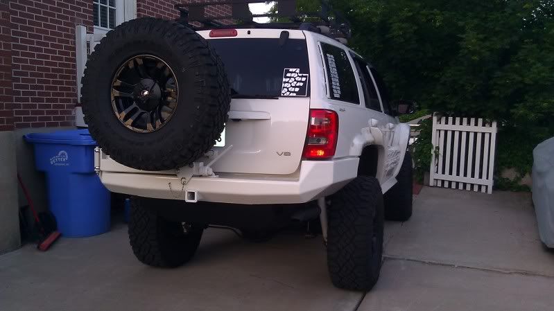

Tank Tucks are a popular thing on the WJ, but I like mine how it is. I was originally on board, and was planning on a tank tuck. However, the factory spare tire well is such a great location to store tools, my compressor, bottle jacks, a set of grease clothes, spare fluids, etc. The best part is that I just crisscross a tie down across the top of the cover between the tie down areas, and it keeps the lid tight and everything in place when wheeling.

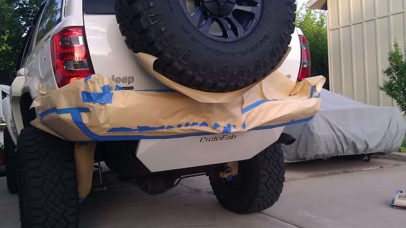

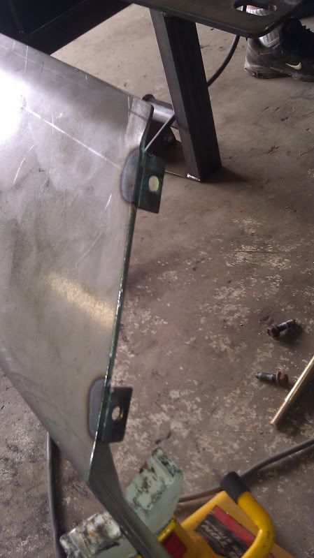

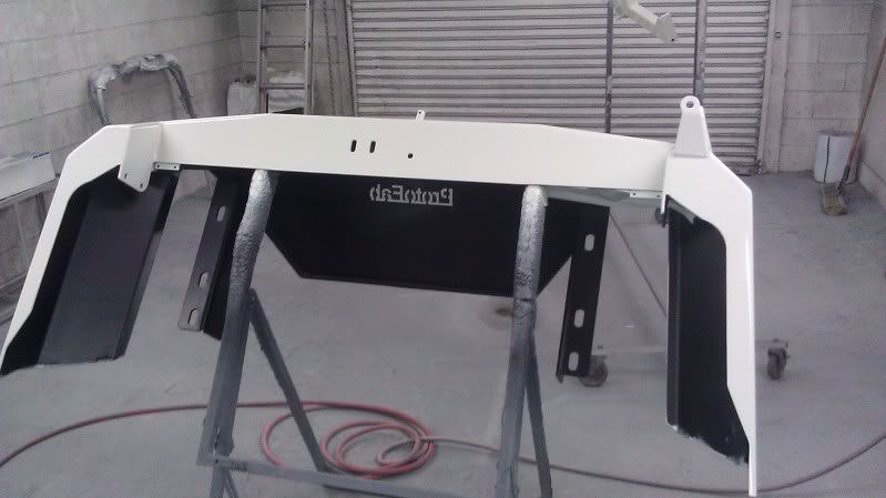

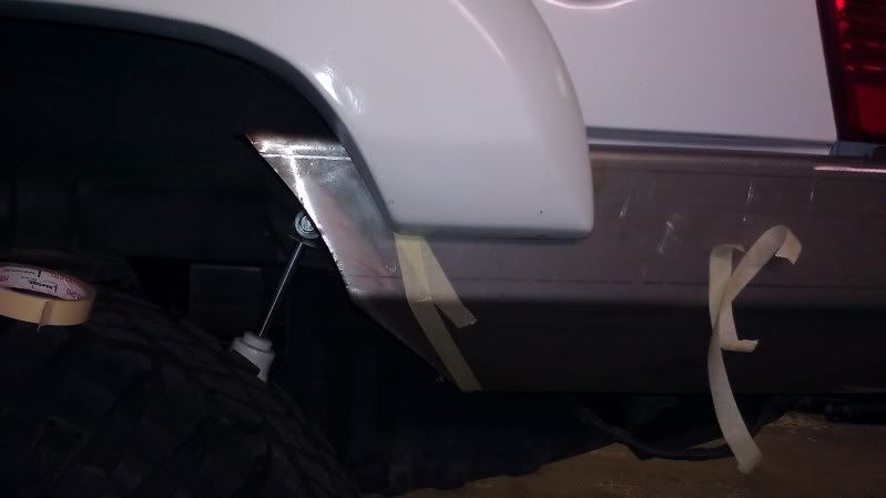

That said, I wanted to paint my bumper to match but didn't want the skid to stand out. So I painted it with flat black to blend with my tank. I like how it turned out, and I like the tank skid. It took a full saturday for me to install it, mark it up, remove it and trim it. Then I had it painted and re-installed it.
Installed the bumper, marked it for trimming to match the line of my fender flares:
I tacked on two tabs per side to secure my mud flaps for street driving, and I have quick release pins holding them on:
Painted:
Installed:
Masked off:
Complete...skid is painted flat black and blends in with the gas tank and undercarriage. I also painted the exhaust tip and pipe black with high temp paint:

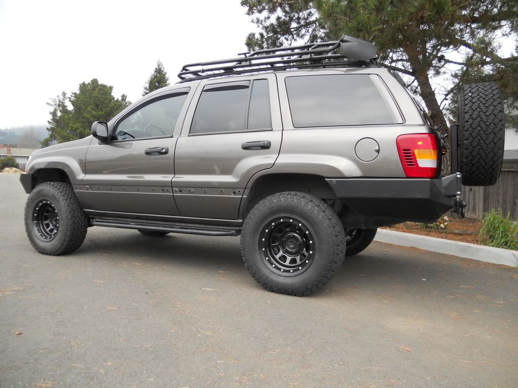

85Iroc or WJChris, can one of you hook us up with a side picture??
04 WJ "Freedom Edition" 4x4 4.0L - soon to be lifted
Hopperstien is offline
post #11 of 33 Old 07-25-2012, 06:32 PM
WJChris
WJChris's Avatar
Location: Santa Rosa, California
Posts: 2,927

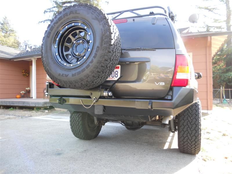

I guess I never took the time to take any, this is all I could find:
WJChris is offline

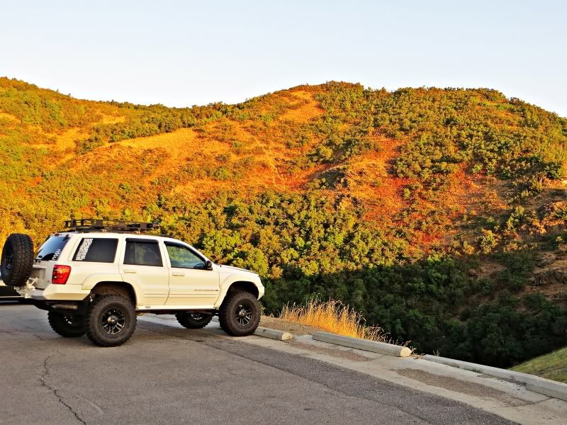

I don't have any real good side shots to choose from, but here are a two that might help...
angle:
side from far away:
