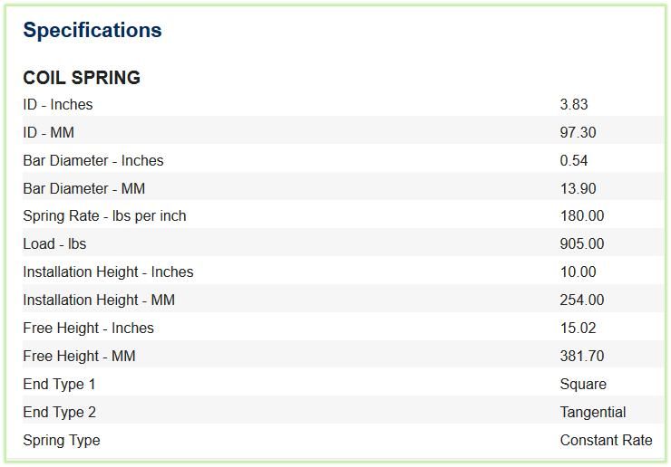

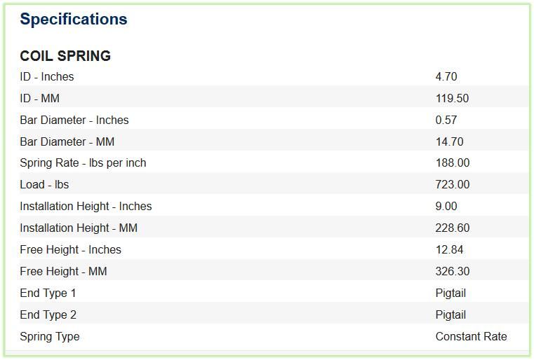

Found some good info on the MOOG springs.
Front Spring Rate
180 - lbs per inch
Rear Spring Rate
188 - lbs per inch
And at $57 a pair, they carry a lifetime warranty. I think this may be the way to go..

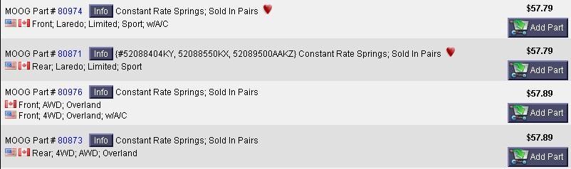

Originally Posted by 2002_GC View Post
The MOOG Springs are specific to the overland models, so I am assuming they are upcountry spec springs.
What Moog part numbers are you showing?
Several auto stores online websites and rock auto are only showing one part number for front and rear springs from 1999-2004.
Every place I look pulls up 80974 for the front and 80871 for the rear. However, O'Reilly's website shows 80873 for the rear when equipped with 4WD, however spring bar diameter and spring rate is the same as the 80871's.

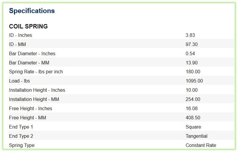

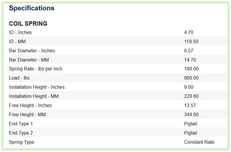

post #14 of 18 Old 12-17-2013, 01:08 PM Thread Starter
2002_GC
Join Date: Dec 2013
Location: Portland
Posts: 16
Here is some additiona info I got from Moog:
Front; Laredo; Limited; Sport; w/A/C
MOOG Part # 80974
Rear; Laredo; Limited; Sport
MOOG Part # 80871
Front; 4WD; Overland; w/A/C
MOOG Part # 80976
Rear; 4WD; AWD; Overland
MOOG Part # 80873
