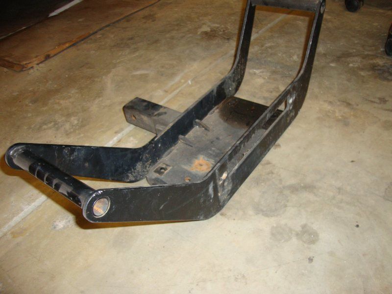

Yeah I'm probably gunna use the Harbor Freight 12k winch plate that I got of Craigslist for 15 bucks a while back. Would make the fab work easier. just trim the back sides flush and add the extensions back to for bolt attachment.
The only problem I see for those looking for this kind of mod is the winch lock/free spool lever needs to face down or forward because it will hit the bottom of the grill otherwise. You can see in the pics of the original in one pic the handle is up and in the other it is facing down.
So you need to make sure the winch you have will let you rotate the end of the winch down. Other wise you can fab the plate to fit on top of the uniframe rails.

Toss that Harbor Freight winch cradle. I had one... the whole thing is made from less than .100"-wall sheet metal. Anywhere you look, you'll see that 1/4" is recommended so that the winch has a rigid base and doesn't get damaged by the plate flexing. I still have mine laying around but only because it won't fit in my recycle bin and I couldn't stand to give it away.
If you are going to build something and start off cheap, the Harbor Freight universal winch plate (not the mobile mount cradle) would make a much better choice.

Yeah the HF winch plate is what I have fabbed currently on my WJ. I also got one off craigslist a wrangle guy bought but said it wouldnt fit his.
Like this...
I used a Black Mountain winch cradle for about 3 years. Its pretty heavy and 1/4 plate. Its still floating around my garage too.
