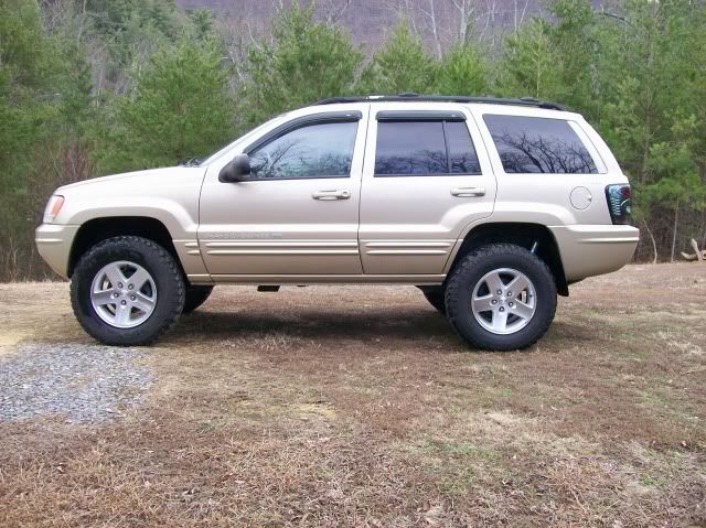

I did exactly what ChrisHager said...
Ordered through Kolak the 3" IRO with their adjustable trackbar, new isolators, bilsteins, and I already had the SSD107 and addco rear sway. I also did all tie-rod ends at the same time.
I love it. Wouldn't change a thing.

IRO is what i have and the only thing i would suggest is buy bilsteins from kolak and the super durometer track bar bushings from KOR . IRO gives you universal brackets for the front shocks and their bushings get mushy quick.
Forestrat: what lights are those?

Oh, and nice looking WJ's fellas!
